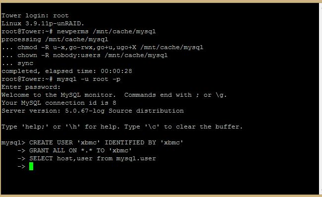

Though I might post here before starting my own topic. The putty commands do not appear to be doing anything at all.
What am I doing wrong
You're missing the semicolon  at the end of the sql commands
Thank you so much
