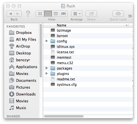

September 3, 201313 yr Install PLGs 1. get the PLG into your unRaid server to /boot/config/plugins This may be a really stupid question Can I put the PLG right on my Flash? i.e. flash/plugins That appears to be where the webGui-latest.plg is
September 3, 201313 yr /boot is where the USB drive is mounted when using the Linux command line environment from a console/telnet session. The 'flash' share is how the USB drive shows up when using shares over the network. They are therefore two different ways of stating the same thing depending on the mode you are in.
September 3, 201313 yr Author So from the Flash does it need to be /config/plugins Or can it be just be /plugins
September 3, 201313 yr to quote Limetech (circa 2011): Also, if you look at /etc/rc.d/rc.local, the sequence is this: a) install slack packages from /boot/extra b) install all /boot/plugins/*.plg files (ie, "system" plugins) c) install all /boot/config/plugins/.plg files (ie, "user" plugins) d) invoke 'go' script you are installing a 'user' plugin.
