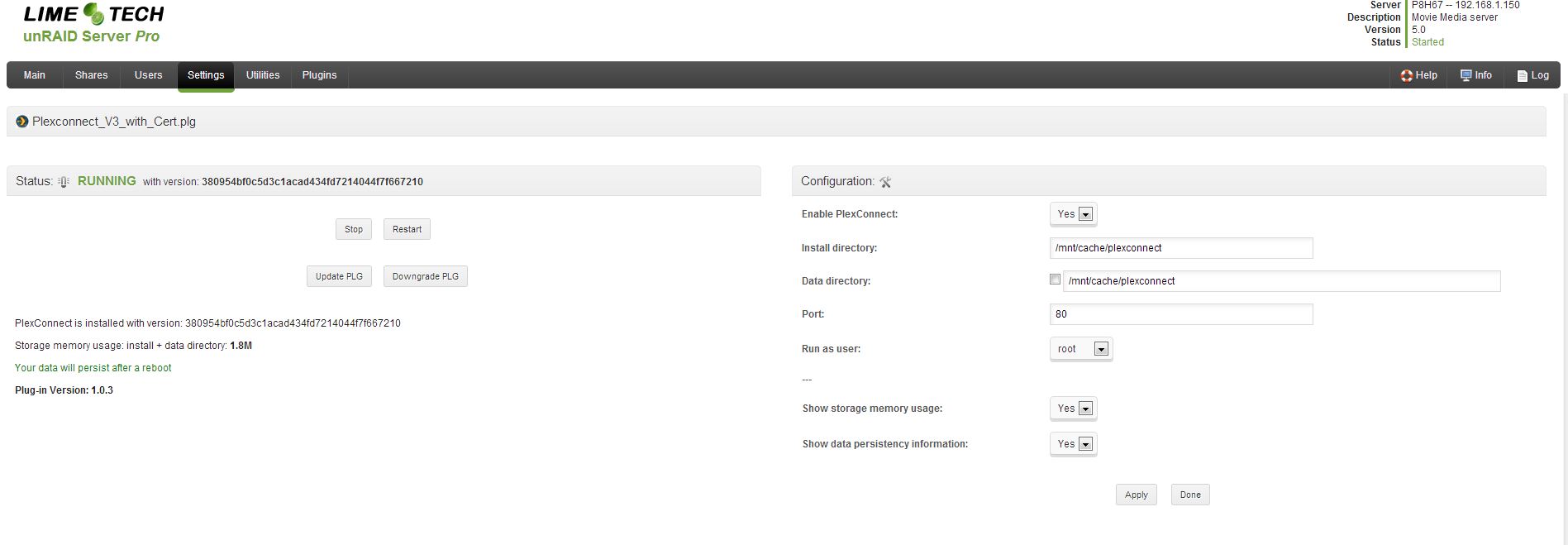

go to settings -> on the bottom in the unplugged section -> click plexconnect
webpage will open
first set settings on the right side of the screen
- Run as user needs to be root .... has to do something with port rights... i left the option there for smarter linux people then me to make adjustments if necessary for them
- data directory is not really used in my eyes but i left it there too.... it works if you want to ....
- Port has to be 80 ... you can change it to whatever it will not affect things much... only your pid wil have a different name
                                    the ports are taken from the settings.cfg from plexconnect this plugin doesn't make any changes to that file....
then install plexconnect
it will clone the latest version to your unraid into the install directory you set...
BEFORE your start though please COPY your Trailers.pem file into /your_install_directory/assets/certificates
start plexconect
it will start a screen session with plexconnect in the background and if both ports are free and the certificate is found plexconnect will start
for any troubleshooting look into the plexconnect.log in your installdir...
it will tell you if there are any port issues or certificate issues

Looks like plugin installs fine... i configure data directory to /mnt/disk1/.apps/PlexConnect save then click Install but it doesn't git pull.
I run command manually I'm getting this error: git-remote-https: error while loading shared libraries: libcurl.so.4: cannot open shared object file: No such file or directory.
UPDATE: This was on a test PC I was trying out plugin. I installed Sickbeard I was able to git pull so that took care of my error above.
I have not been able to get plexconnect working.  when using the plugin plexconnect would not install.  After reading that another user was able to install it after sickbeard was installed I tried that.  plexconnect installed once sickbeard was installed (is this supposed to be a pre-requisate) but when I start plexconnect I get an error:
screen: error while loading shared libraries: libutempter.so.0: cannot open shared object file: No such file or directory
not sure what's wrong, i have tried deleting and re-installing, but the results are the same.  Is there any other packages required? my unraid version is 5.0 and the only thing I installed was plex.

updated plugin to account for the missing packages ....
let me know if it works now
Still not working for me with the new package, getting the errror:
git-remote-https: error while loading shared librarys: libcurl.so.4:
