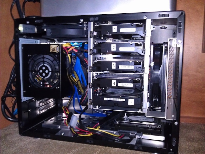

I definitely prefer using SFX power supplies, however => I've built one with a CX430, and every one since has used the Silverstone SFX units, which provide MUCH better airflow.  Here's a picture of the case with an SFX PSU:

As far as Psu I stopped using Cx430 after first build and went SFX. Much better, you're right with that. Might do some fan swapping to some Scythe gentle typhoons maybe.

It fits perfectly (as noted by trurl above).      Note that if your supplier has them, there's a newer 300w Silverstone SFX unit that's an even better choice, as it will be operating in its more efficient range at the lower power levels a mini-ITX system will draw.

I am running the Silverstone ST30SF (300W) in my PC-Q25B build with 6x 7200 rpm drives and can verify it works great!  Getting rid of the full size ATX PSU in my build was one of the best upgrades I've made.
