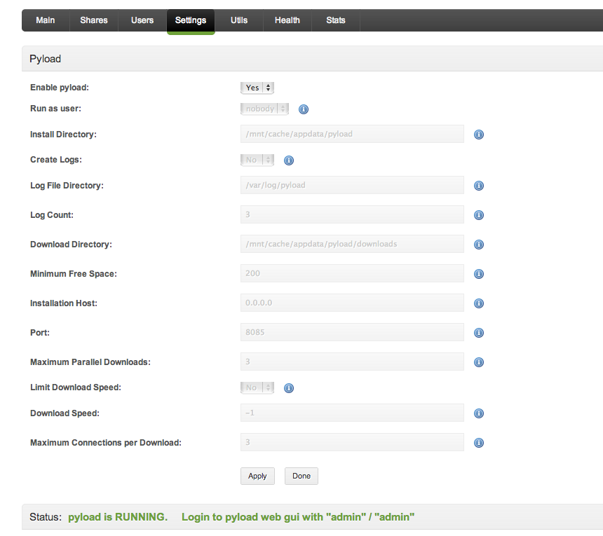

I did what you said, and I guess to confirm the path to which i had this installed was indeed: /mnt/cache/appdata/pyload    (was keeping it short)
Here is what i have done.  I removed the plg for pyload, removed any files/directories between flash and cache drives and rebooted server (fresh start)
Added the pyload plg back, and installed.  COnfigured the plugin vie unRaid (see pic attached) and started.
I then ran your first command and did get the odd response.
So I downloaded your link, installed the pkg for curl and then tried your command again.
I did not get a process ID.  Here is what I get:
