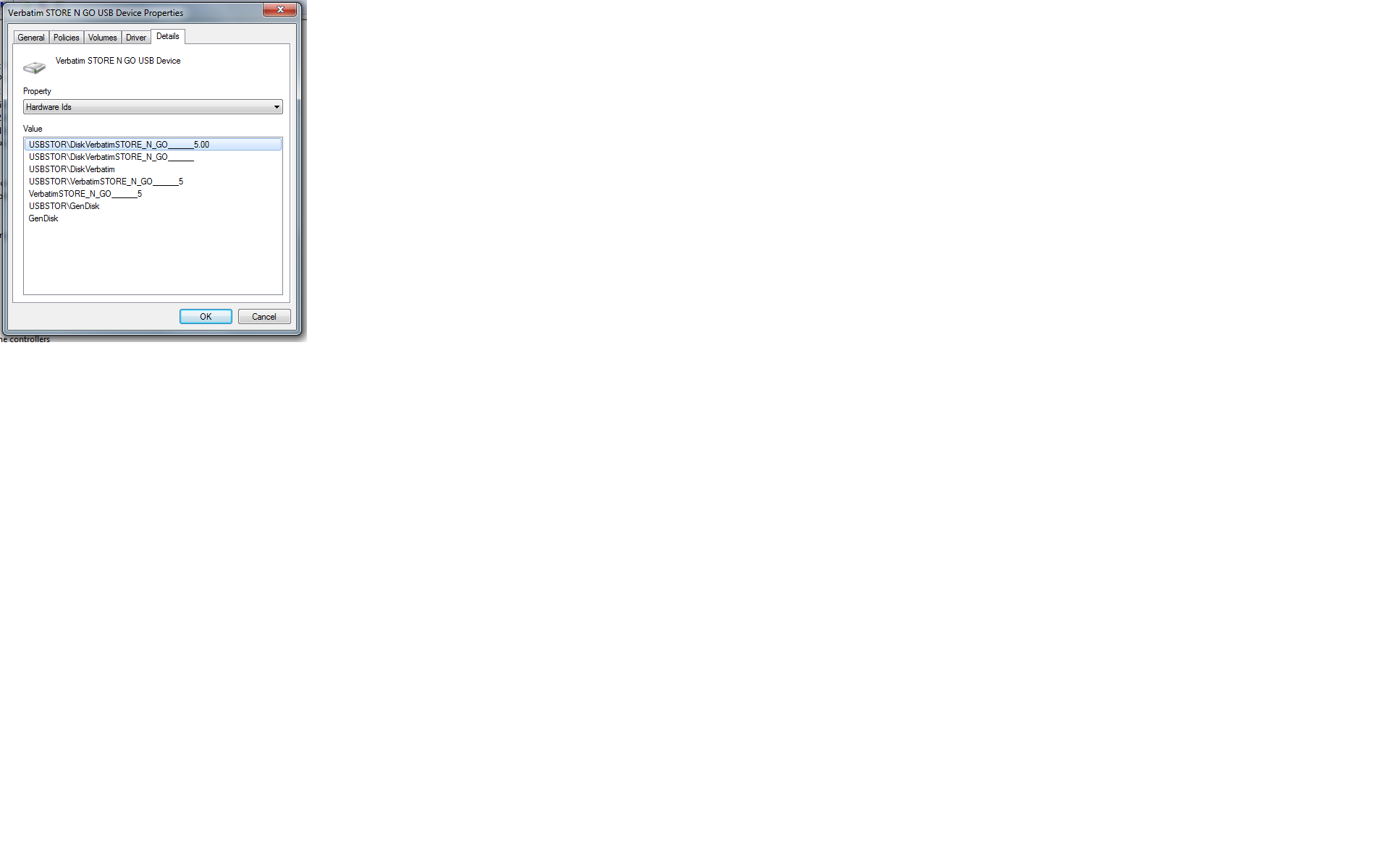

Looks like it is having trouble completing the download for crashplan. try a different plugin.
since you are suspicious of the USB stick, can you tell us which brand/model/size you are using?
It is worth pointing out that permissions are not relevant to the USB drive as is formatted as FAT.  It might be worth running scandsk on a Windows system to check there is no file system corruption.
Looks network related to me... Firewall?

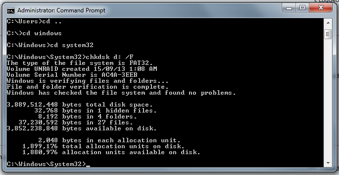

Thanks guys, I've tried your suggestions.
Chkdsk returned no errors (see attached chkdsk.png). The details of the USB stick are: Verbatim Store N Go 4GB (see attached usbstick.png).

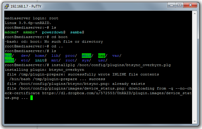

I have tried installing BTSync but with much the same result (see telnet.png). Could be a firewall issue on the router, what ports should be opened for unRAID?
Thanks again

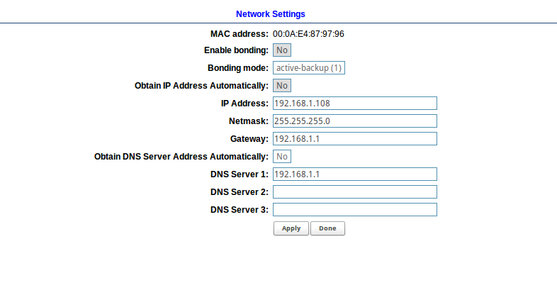

OK this is still driving me nuts. So the output from Google is fine but from Dropbox it fails. It appears that I spelt everything correctly. And sorry I missed the ifconfig, please see below.
eth0  Link encap:Ethernet  HWaddr 00:0a:e4:87:97:96
          inet addr:192.168.1.7  Bcast:192.168.1.255  Mask:255.255.255.0
          UP BROADCAST RUNNING MULTICAST  MTU:1500  Metric:1
          RX packets:600407 errors:0 dropped:24 overruns:0 frame:0
          TX packets:705892 errors:0 dropped:0 overruns:0 carrier:0
          collisions:2 txqueuelen:1000
          RX bytes:95653476 (91.2 MiB)  TX bytes:635641932 (606.1 MiB)
lo       Link encap:Local Loopback
          inet addr:127.0.0.1  Mask:255.0.0.0
          UP LOOPBACK RUNNING  MTU:65536  Metric:1
          RX packets:44 errors:0 dropped:0 overruns:0 frame:0
          TX packets:44 errors:0 dropped:0 overruns:0 carrier:0
          collisions:0 txqueuelen:0
          RX bytes:3148 (3.0 KiB)  TX bytes:3148 (3.0 KiB)
Again thank you for any time you guys can help me with troubleshooting this... I know it's painful helping a novice like myself troubleshoot what is probably a simple configuration error somewhere...
That's what the forums are for! Is that ip static?
If so are you sure the ip is in the correct subnet? I know it seems to work google, so I dunno, but the rest of your errors look like a gateway issue. If the ip is a 192.168.1.. And the gateway is a 192.168.0 or .2, you would see problems similar to this. Have you tried it on DHCP?
Otherwise, try a trace route to 8.8.8.8 and post the results.

What does "ifconfig" and "ethtool eth0" show? Attach a screen shot of Settings->Network Settings
OK here is ifconfig:
Note I have changed the ip address to 192.168.1.108 which is assigned through the unRAID interface and I've tied the MAC address to that ip address too in my router. Just trying pengrus' solution.

58aad71ae9278_Screenshot_from_2013-09-26_131352.png.299472b821a796c2815584ad4289f31e.png
Try with both of the automatic settings set to yes.
OK done that, here is the ifconfig now:
