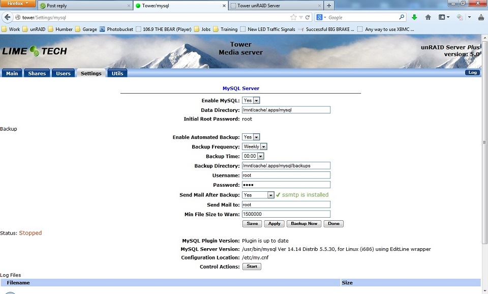

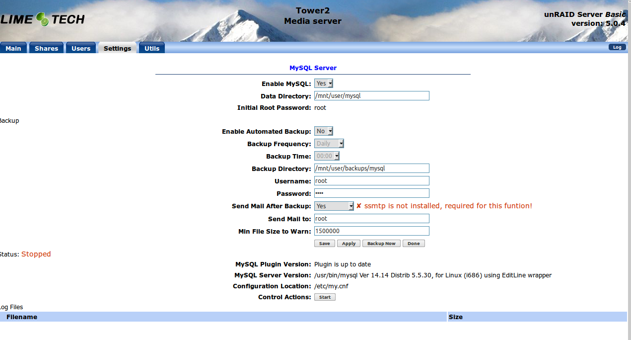

can't get this to start.
the plug in is installed, and I can load up the settings page. but when I hit start it just refreshes and it still saying stopped.
screen shot of settings page attached.
Try apply
If not, try "/etc/rc.d/rc.mysql start --user=mysql" this command from command line and see if there is an error

I tried "/etc/rc.d/rc.mysql start --user=mysql" from command line and it gave the following error:
"Error! the server quit without updating pid file (/var/run/mysqld/mysqld.pid)"
I then thought to change when there Mysql data directory was set to /mnt/user/mysql and then tried to start the plugin - it worked first time.
I then tried starting it with "/etc/rc.d/rc.mysql start --user=mysql" and it also worked.
I would rather that the mysql data was set to the cache drive, any help appreciated.
Thanks
Hi ikosa,
My first unRAID server got updated with a new motherboard, CPU, RAM and cache drive so I decided to try this plugin on the old hardware.
This new server has three small HDD's and runs the latest version 5.0.4 on a brand new flash drive.
First I installed control panel plugin (BTW love it) then mysql using control panel.
After the installation everything looked OK, used Apply and the server started but if you stop the server using the Stop button from the plugin page the server cannot be started from either the plugin page or the control panel plugin by pushing the start button, or by clicking on the Apply button. I also tried to change the path on the plugin page and then hit apply but no result.
The /etc/rc.d/rc.mysql start --user=mysql returned
Starting MySQL. ERROR! The server quit without updating PID file (/var/run/mysql/mysql.pid).
The only other thing installed on the machine is unMenu, do I need to install SimplFeatures also like in your setup?
Hi soana,
will you try and share output of these commands:
ls -l /mnt/user/
ls -l /mnt/user/mysql
intalling simplefeatures is up to you it is not needed for control panel or mysql. And they all run with it without problems.

As i said before it seems like there is a problem with permissions. Try:
chown -R mysql:users /mnt/user/mysql
Than try to start mysql again.
