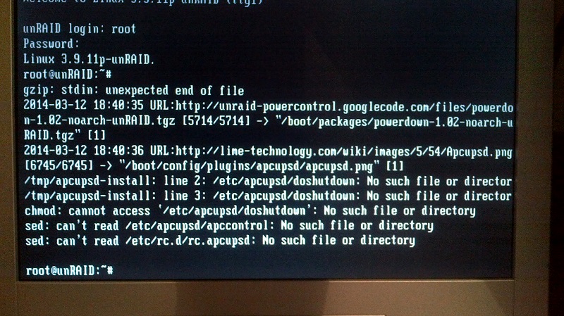

I didn't know where to post this as it might be a control panel plugin issue, but here goes.
I installed APCUPS pluging 3.14.10 from control panel and it seems to install ok by the log at the top of the page
success
file /boot/config/plugins/apcupsd/apcupsd.png: downloading from http://lime-technology.com/wiki/images/5/54/Apcupsd.png ... success
file /boot/config/plugins/apcupsd/apcupsd.cfg: successfully wrote INLINE file contents
file /tmp/apcupsd-upgrade: successfully wrote INLINE file contents
  /bin/bash /tmp/apcupsd-upgrade ... success
file /usr/local/emhttp/plugins/apcupsd/apcupsd.png: successfully copied LOCAL file
file /usr/local/emhttp/plugins/apcupsd/apcupsd.page: successfully wrote INLINE file contents
file /usr/local/emhttp/plugins/apcupsd/apcupsd.php: successfully wrote INLINE file contents
file /usr/local/emhttp/plugins/apcupsd/apcupsdctl.php: successfully wrote INLINE file contents
file /tmp/apcupsd-install: successfully wrote INLINE file contents
  /bin/bash /tmp/apcupsd-install ... kernel.poweroff_cmd = /sbin/powerdown
Saving Settings...Completed
Stopping apcupsd...Completed
success
file /var/log/plugins/apcupsd: already exists
plugin successfully installed
but way down the control panel install page it shows not installed, also the settings page also shows this:
Daemon: Stopped  UPS: Offline
The terminal shows some errors, see attachment pic
The APCUPS plugin didn't install properly and I don't know why, it installed and worked well using this method on my testbox
I've had a couple of tries at this, same thing each time
Any help appreciated

Post a full system log.  What other plugins are you using?
One thing I see is that the version you are using installs an older version of powerdown.  While this is not the problem you are having with apcupsd, you should update to the newer version posted in the OP.
Here is the log. I noticed a "wget: unable to resolve host address" for a APCUPS related file on the boot up this morning, so I will have to dig into that later on today.
Running v5.0.5 with plugins OpenVPN, Transmission, MySQL, vsFTP
syslog.txt
You have several things going on here.  The first is that unRAID 5.05 is known to have an issue when booting up.  The plugins try to download packages before the network is up and running.  That looks like what is going on here.  It is affecting apcupsd because it is the first plugin to be installed.
The other thing is the apcupsd package you are using is an older package.
Here is what I would do:
- Remove the apcupsd plugin.
- Remove the powerdown and apcupsd packages from the /boot/packages directory.
- Download and install the version of apcupsd on the OP.
Installplg apcupsd, or re-boot.  This plugin waits for the network to be available and shouldn't fail when downloading packages after a re-boot.
Ok, did as you suggested and it did not work on reboot with the same error in the terminal appearing "wget:unable to resolve host address etc," and these lines in the syslog.
Mar 13 18:31:16 unRAID logger: installing plugin: Apcupsd-3.14.10-i486-4_rlw-dl
Mar 13 18:31:16 unRAID logger:  file /boot/packages/apcupsd-3.14.10-i486-4_rlw.tgz: downloading from http://slackware.org.uk/people/rworkman/14.0/i486/apcupsd-3.14.10-i486-4_rlw.tgz ... bad download, deleting
So going back to my testbox I tried the manual install and all went well, so I did the same for my main unraid and it also installed and appears to be working.
I guess that network issue with v5.0.5 is causing the problem?
Also will the manual install survive a reboot?, seems it did on the testbox, have not tried the main box yet
thanks for taking the time to help and all your plugin work
Probably.
Yes.
