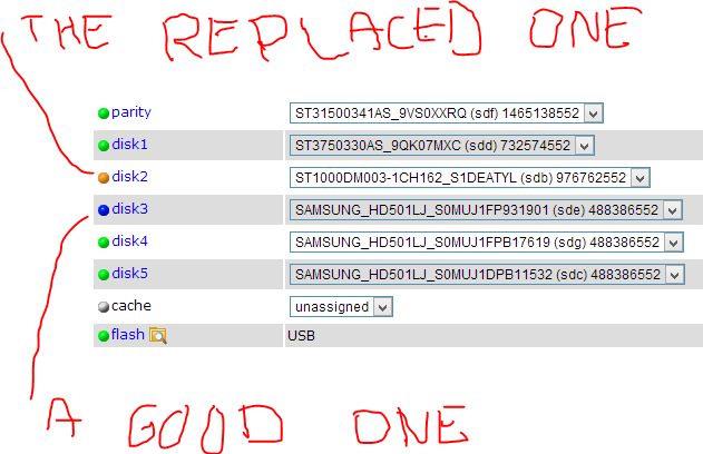

One of my disks failed today. I replaced it instantly with a new one. On the beginning of data rebuild a lot of errors appeared on another drive. Like i found later it was a problem with my case or Sata cable (most probably). I replaced the sata tape and reboot server. Now my disk which had been replaced is orange (indicates interrupted data rebuild) and the other one is blue. What can I do to make unraid know that the blue-one is actually a proper disk, and make it rebuild the new one??

Do you know how to make the array trust that it is correct and then se the replaced disk as invalid?

I did as you suggested Webo, and everything would be fine but the parity check started even when i had ticked "parity is already valid"!!! This corrected 326 "errors" ony my parity drive. Thankfully i stopped it soon after that. So i think some files will be broken now. What should I do when the disk gets fully rebuilt?
