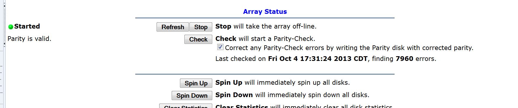

hmmm okay here's an update
initiated a parity check WITH correct yesterday.  ran all day, night and into today
after it was completed, it said that it ran and found 7960 errors, the same as the prior check.  didn't mention correcting them, but then again,  i'm not sure if that's normal,  i've never had an error before!  so here's a pic, is that normally how it looks when it runs, and is corrected?  or is it still not corrected?

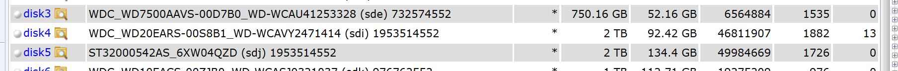

ALSO noticed that the error column now shows errors for the drive that we've discussed before (one of the 3 that had pending reallocated sectors).  it is now showing 13 errors!

so i ran the correcting parity check yesterday and it seemed to work... i noticed though that it said the drive with the most pending reallocations now had 13 errors!
the weird part (i think) is that i've copied everything off it as of a few minutes ago, and now the main unraid page is now showing that that particular drive does NOT have any errors?  not sure if this is expected, or odd
