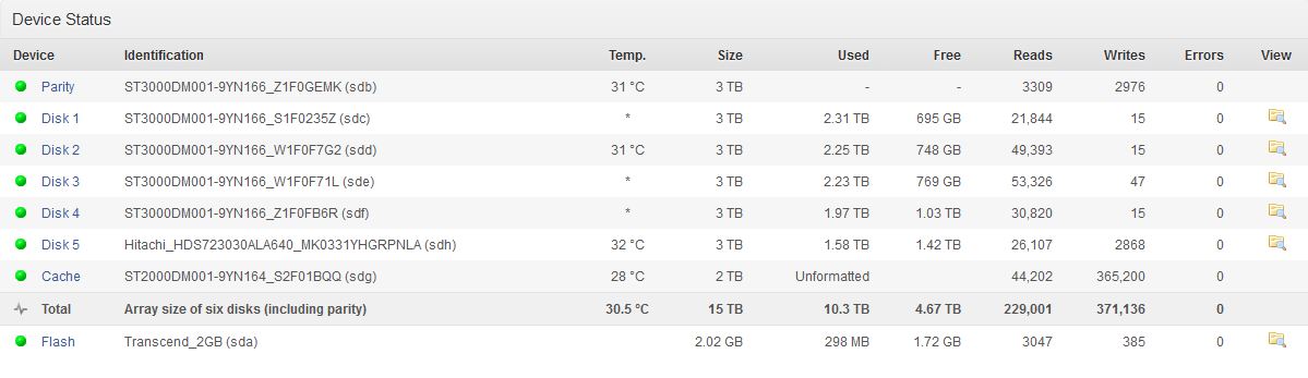

However I have one noob question for you, since this is a cache drive what would it be md1/md2 etc? Attaching a screenshot of my main page and disk status. Cache is sdg on that - does that mean anything?
Just wanted to ask if you have upgraded to Release 5 yet?
Sideband - that is what started all this, I have had issues with emhttp crashing and tower not being accessible even via console either (hard reboot is the only option) from RC16 onwards and that still continues with 5.0 (I have tried stock on 5.0 still this happens), I tried and reverted back to RC13 and then this un-formatted issue happened.
Thanks for all your help.
Use /dev/sdg1 to check the cache disk. Do not forget the trailing number 1.
Thank you. Will run reiserfsck and see if it fixes it all good.
