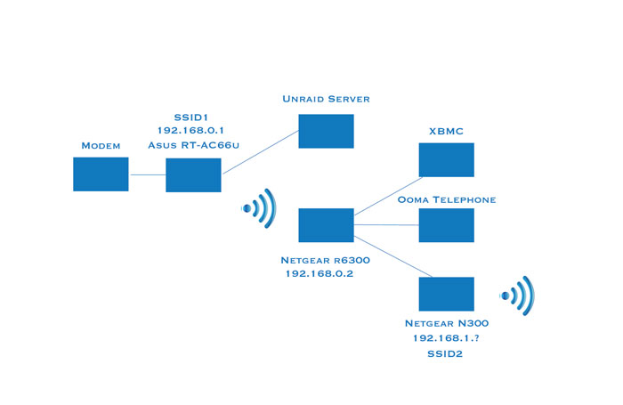

@dgaschk I have attached a diagram of my network, there are other things attached to the netgear routers such as TV, DVD player and Stereo Receiver. I left them out of the drawing so that it wouldnt be too cluttered.

The 10M Ethernet connection needs to be fixed. It should be at least 100 and preferably 1000. 10M will limit streaming as your seeing. 100M should work fine. If the issue persists on a 100M or 1000M connection then eliminate the WIFI hop between the client and server. Use a very long CAT6 cable or move the client and/or server closer together and test performance.
