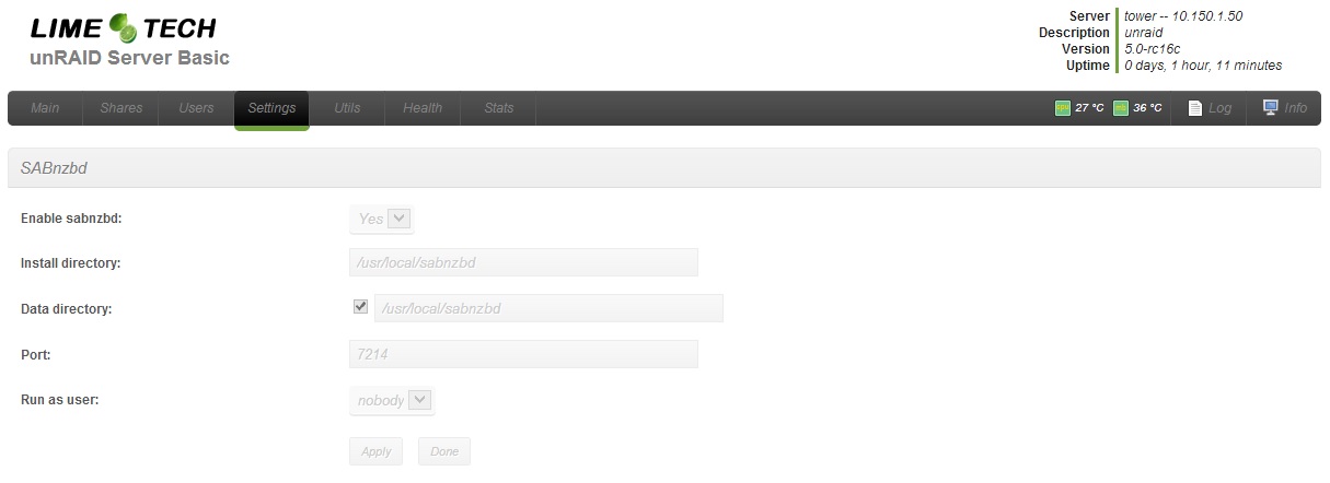

I've installed the sabnzbd-0.4c-i468-bw plugin and have it running on the unraid. configured the setting that i see on SimpleFeatures v1.0.11 screen
click apply and all that happens is the screen greys out and I sit and wait. Bottom of the screen I get;

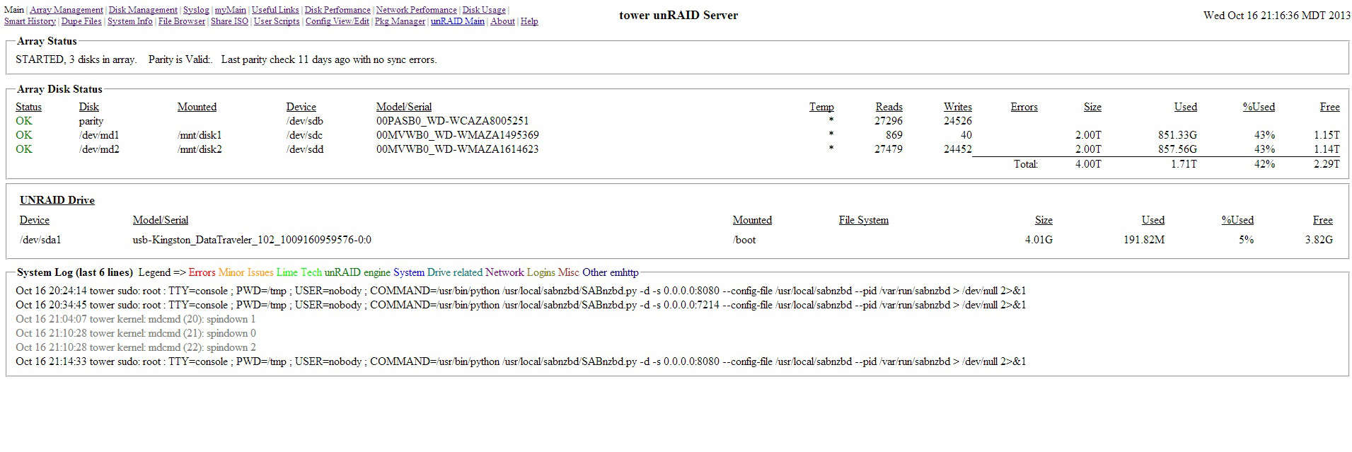

Starting sabnzbd: sudo -u nobody python /usr/local/sabnzbd/SABnzbd.py -d -s 0.0.0.0:7214 --config-file /usr/local/sabnzbd --pid /var/run/sabnzbd > /dev/null 2>&1
how do I get to the main Sabnzbd config screen or am I doing something wrong?
Won't connect,
i'll try port 8080 as it was the default.
with port 8080
it just takes me to the unmenu.

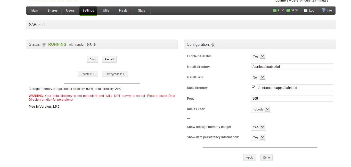

Awesome thank you, got it installed but wondering about the warning??
Run this and let me know the output
stat -f -c '%T' /mnt/cache/apps/sabnzbd/
pls forgive my stupidity, can you please point me in the right area as where to run that command?
Either from the server with a monitor and,keyboard attached or from telnet. If you don't have a telnet client installed you can download putty for free.
Ramfs is the reply
Ok, either you entered your path wrong or you don't have a cache drive?
I'm running off the free version and don't have a cache drive.
well if your running the free version you always have the option to setup the config files to run from a disk drive... that's what i did when i ran it from unraid but doing that will cause the parity drive to spin aswell...
Mount a disk outside of unraid and use that especially if it is an SSD.  This will work with the free version as long as SABnzbd can be configured to use it anyway.  Don't use it so don't know.
See jumperalex's post here for how to mount it from GO file that will survive reboots.
