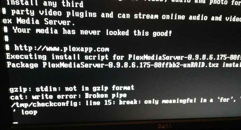

i have unraid 5 Final running and i suddenly have this errors:
gzip: stdin: not in gzip format
cat: write error: Broken pipe
/tmp/checkconfig: line 15: break: only meaningful in a 'for', …
you can see, that this is the first entry after PlexMediaServer from /boot/extra is getting installed without errors. i can't see the problematic plugin/script that is doing this errors. after a long wait, the boot is continuing without any further interruptions and unraid is running smoothly.
do you have any suggestions to find out what is causing this errors?
thank you in advance

i moved the plex library away for tests but the problem still exists.
here is my recording of a 5(!) minute boot time. http://www.youtube.com/watch?v=FNx1Ze8Ya1A&
any ideas? unraid is running pretty nice but the boot time with this error is horrible. and my server start often during a month.

so big update here:
i renamed the plugins folder and tested all plugins step by step during boot ups with a stop watch.
1
istatd is giving this errors during boot:
sh: /user/local/etc/istat.conf: No such file or directory
istatd: no process killed
chown errors
starting as root bla bla etc.
2
sickbeard is giving this error
3
pyload is giving this error
and during testing (a lot of restarts), couchpotato is responsible that my emhttp is not starting correctly anymore. without coachpotato it's running smoothly. have to fix this as a new problem.
i will stop using pyload, because its crap to setup and maintain downloads. will wait for a more easier way.
