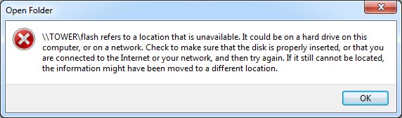

I just upgraded my tower from 4.7 to 5.0 and everything worked out pretty well. I ran the New Permissions as the install instructions indicate. I have no additional  users (other than root) as everything is public on the network (though if you look at my syslog I did add a user but then deleted it). I was able to access my files after the upgrade. So after I thought everything is working smoothly, I went to backup my Flash drive folder but came up with the following error message about that location not available.
Can anyone help me on why I am not able to browse to my Flash folder to back it up?
SOLVED: It seemed to be a Windows problem. Restarted my computer I used to access the tower solved it.

Control Panel > Credential Manager >  delete anything unraid related and try again.
I see no credentials or certifications in the Credential Manager on my Windows 7 machine.
I noticed that my share called Documents also did the same thing, but the rest of my share folders worked fine.
So now thinking it might be some sort of Windows issue with my Flash and Documents folder not working, I restarted my Windows 7 machine, tried accessing those folders again and everything worked just fine.
