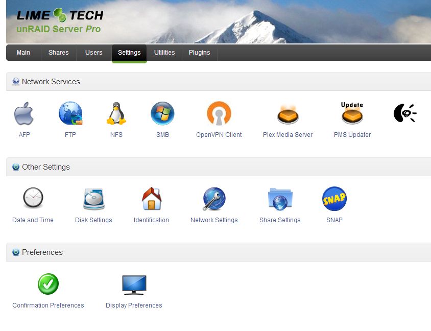

Removed Simplefeatures and do not see the plugins yet (screenshot below) .... I am just happy that the plugins (SABnzbd, CouchPotato, Sickbeard, Transmission) are still running although not visible here.

That does not look like the stock interface.
agreed. did you reboot after removing the simplefeatures plugin?
Thank you dgaschk & mr-hexen, I found the culprit.
It was webgui (http://lime-technology.com/forum/index.php?topic=28839.0)
Rebooted few times trying to isolate the issue. Now simplefeatures is back up and I can see all plugins.
dgaschk - Thank you again for the detailed step by step checklist.
