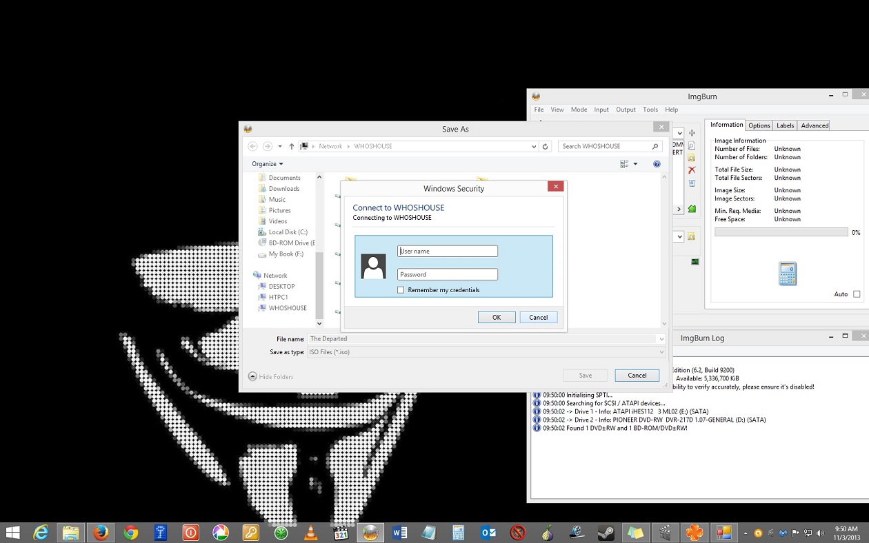

This just randomly started and im not sure why... I can access my server and view all files there but heres my problem...
I was ripping one of my blu-rays and was using imgburn to make an iso. I usually save the ISO right to my server so i dont have to move it from computer to server later. This time when i try to save it to it it wants me to enter a user name and password. Its already prefilled in with my server log in "root" and there was a password. I erased password and put in the password for my server and it has an option to remember credentials but it doesnt sign me in. Ive never seen this sign in before...? Any ideas? Thanks...using version: 5.0-rc12a

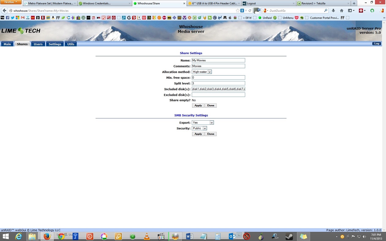

forgive my ignorance. You mean delete my Windows Credentials from control panel correct? I see when I click on one of my shares I have set up it says under "SMB Security Settings" Security: Public....I hope this is what you're referring to. Ill wait for confirmation on deleting my Windows Credentials...I dont know of any other credentials just want to be safe

i attached a screen capture of the log in. maybe that will help spark some ideas...whoshouse is the name of my unraid server
Shares set to public should not be requesting login information. Make sure the share is set to public and reboot the server and the client.
where it says SMB Security Settings. Then it says security: public. is that how i tell that its a public share??
Yes that share is public. Are all of your disks included? If so, leave the box empty.
Yes they are all included. I didnt know I could leave blank to include them all, thanks...any other thoughts on the sign in?
