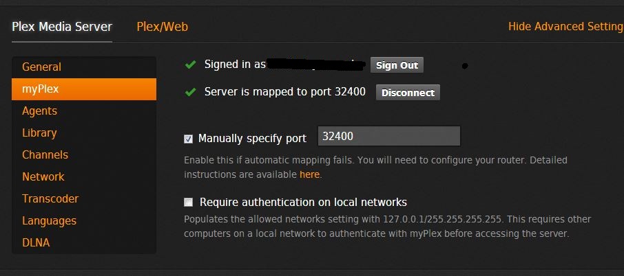

I logged into the VPN and checked that MyPlex and working and it seems to be fine (see the screenshot).
I then log into the MyPlex website and it says that the server is Unavailable but if I connect back to the VPN then it says connected... I am assuming my port forwarding is messed up?
Alright I figured out the port forwarding problems and that is all fixed.
