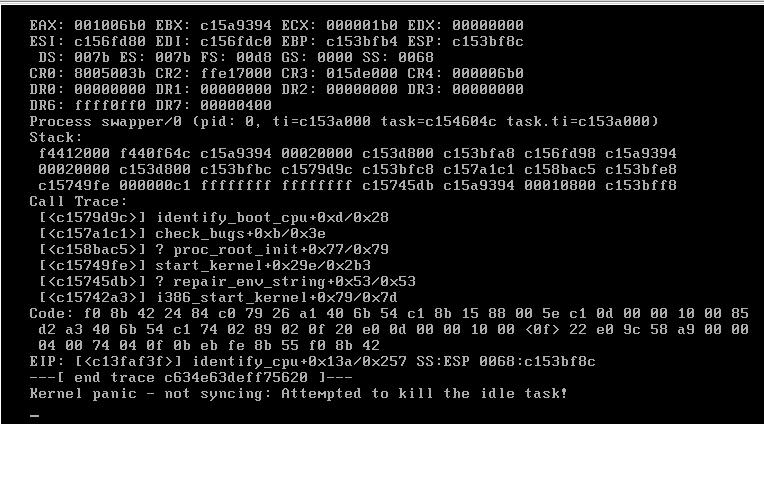

I got kernel panic as shown in the attached screen capture while booting up unRAID.
I searched the forum for the "kernel panic" post; but did not get anything[well may be the info/hints are there, but it is just over my head :( ].  Help and pointers will be much appreciated.
