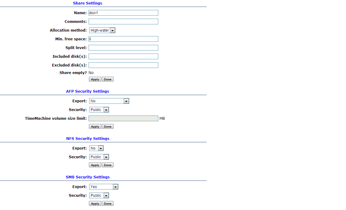

What are the share settings? Attach a screenshot.

You don't need to Create the disk1 share as it appears you have.
If you happened to name it Disk1, capitalizing the D, unraid and any linux OS will treat it as a separate directory from disk1, but windows will see it as one and will show the contents of the first one that it "finds".
Not sure if that's what is going on here, can't see the pictures too good on my phone.
Naming a User share "disk1" is a bad idea. This share already exists by default and the name will conflict with the existing Disk share named "disk1". Call the share "Disk1A" or something. The name "disk1" is already being used.

Thanks for the inputs.  Exactly, Windows sees the disk1 share, with an apps folder inside.  It doesn't see the mnt/disk1 wherein there are .sabnzbd, .sickbeard, etc folders.
Right now, I don't know how to delete the disk1 share as I didn't create it.  I tried to do delete apps folder by issuing rm -rf apps, and it does delete.  When I go to the share properties, it still says not empty.  When I reboot, it reappears.  Since apps inside disk1 is never deleted, I can't delete the disk1 share.
I suspect the apps folder inside the disk1 share was created when I installed Plex, and when it asked for Library, I might have put inside the path of /mnt/disk1?  I'm not in front of the computer, and can't verify.  Therefore, it created a share named disk1, and a folder inside named apps, inside of which is another Plex folder, with Plex files.

did you try typing \\tower\disk1 in windows explorer? the disk shares may be set to hidden.
The "share settings" for the disks are not on the Shares page. From Main, click on the disk to get the settings for that disk. Then you can set the share settings for that disk.

Thanks for your help.  I was staring at the pages where shares are mentioned, but I guess I'm not really looking.  SMB export is set to No.  Thanks for the help guys.
