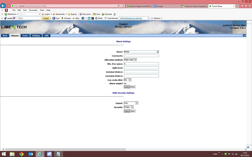

What are your share settings and also check the settings\user shares since there is a global disk include and exclude there.

Attach screenshots of the share settings and a syslog.

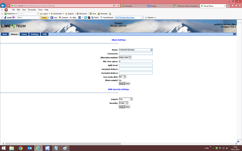

Here are screenshots of my problem shares how you can view them this is all new to me!
I have a media share for home movies etc and a customer backup share which I backup peoples pictures etc

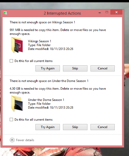

ok I turned off the cache drive in the shares and tried copying some tv shows to media tv on disk 1 and got this error

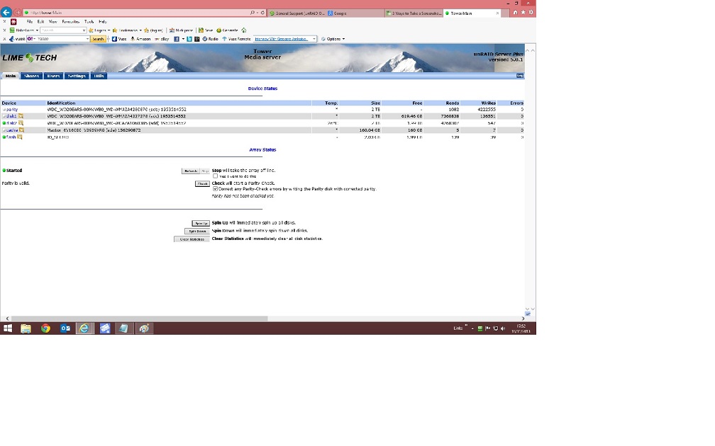

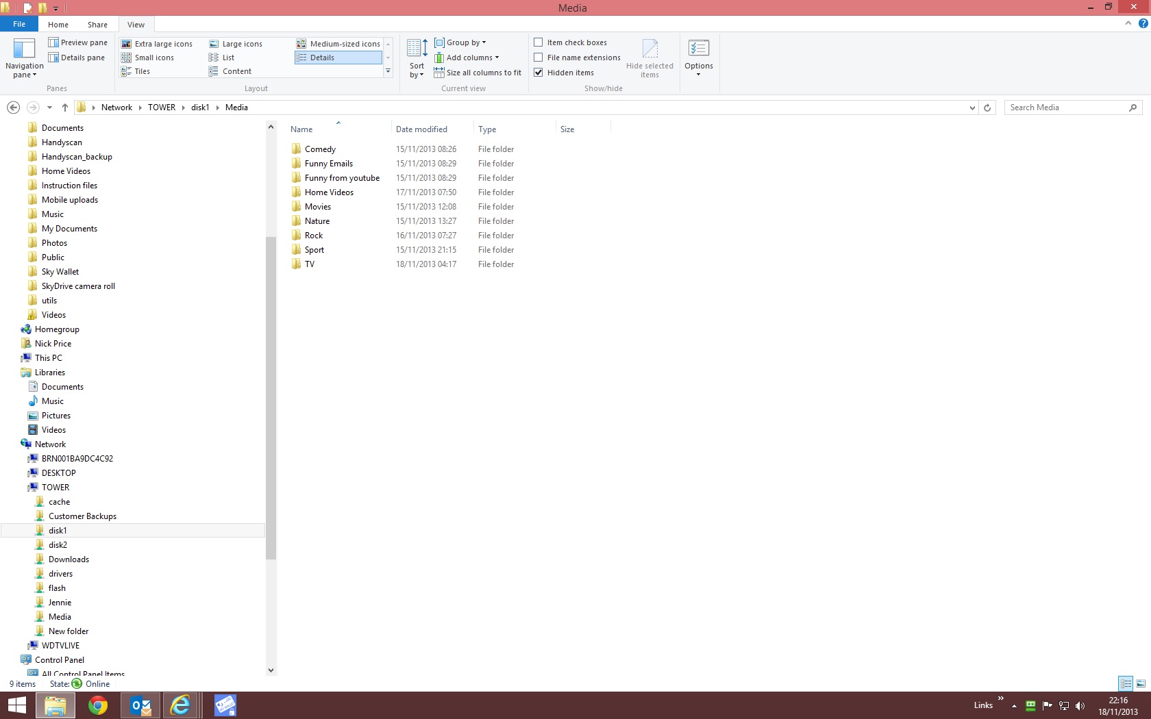

How are you assigning the shares to particular disks? This is not reflected in the share settings. What is the path of the destination? Show some Windows screenshots that indicate the destination. Please try make the images larger. The Shot of unRAID main is not legible.
ok I am struggling to get the size small enough to be able to post, I dont think I actually assigned a drive to the shares just added a new share.
