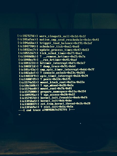

None of it's services are available. Attaching a monitor showed what seems to me a kernel panic. I took a picture of it and attached it to this post.

There is no attachment. Can you connect via telnet?
Preclearing the disks before adding is what I always do. Making a copy of the thumb drive I did forgot..oeps. Print on the hdd arrangement...check. Other then that the problem solved itself somehow after a reboot.

I forgot the attachment. Now there is one. If someone knowledgeable can shed some light on this...super?
