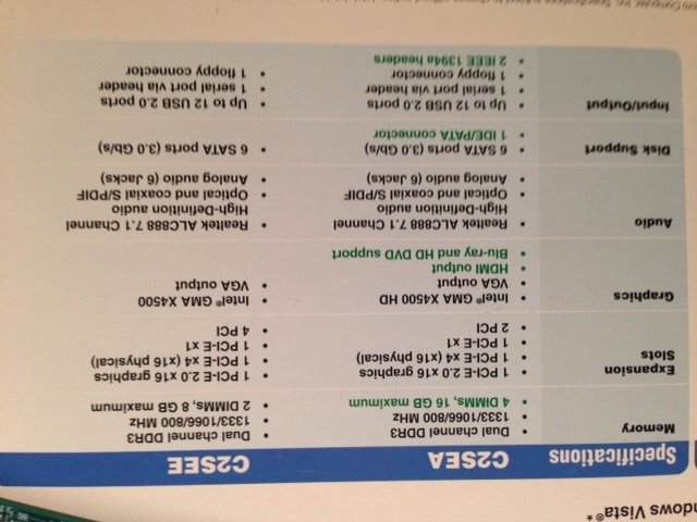

I recently decided to grab a spare C2SEE mobo I've had for a few years now from the closet since I am about to rebuild my unRAID box with a new case I just purchased, but now I need to get some RAM. Figured I would max it out, but now I'm confused. According to newegg and specs on the supermicro website, the board maxes out at 4GB (with C2SEA maxing out at 8GB), but the box says the C2SEE maxes out at 8GB (and the C2SEA is 16GB). I know that sometimes boards reference maxes for the modules that exist at the time the board is released, and maybe firmware upgrades can increase maxes, but can anyone tell me 100% what the max for this board is?
See attached for a pic of the box I took.
Supermicro is very conservative in specifying their RAM capabilities.  I've seen several boards that list a 4GB max that work just fine with 8GB.    The only way to know for sure is to simply try it.  I'd buy a pair of 4GB modules ... assuming they work fine, you could always add 2 more.
I know the Supermicro board I used in my andromeda build can go above the max stated.  If i remember correctly I have running 12GB of RAM in that board right now when the max that is stated for it is 8GB.
Supermicro is very conservative in specifying their RAM capabilities.  I've seen several boards that list a 4GB max that work just fine with 8GB.    The only way to know for sure is to simply try it.  I've buy a pair of 4GB modules ... assuming they work fine, you could always add 2 more.
If I remember correctly the C2SEE only has two memory slots so buying in pairs would not work.  My C2SEE only has 2 memory slots can't say they all do.
You're correct.  My C2SEA has 4 slots; but the SuperMicro specs indeed show only 2 slots on the C2SEE models.
So the best you can do is 8GB, using a pair of 4GB modules.  Although SuperMicro's specs show the board only supports 4GB, it will almost certainly work with 4GB modules for an 8GB total.  As I noted above, the only way to know for sure is to simply try it.
I had a feeling it would, just wanted to check with others that may have the board. Figured for ~$25 more I could get 8GB instead of 4, so might as well.
