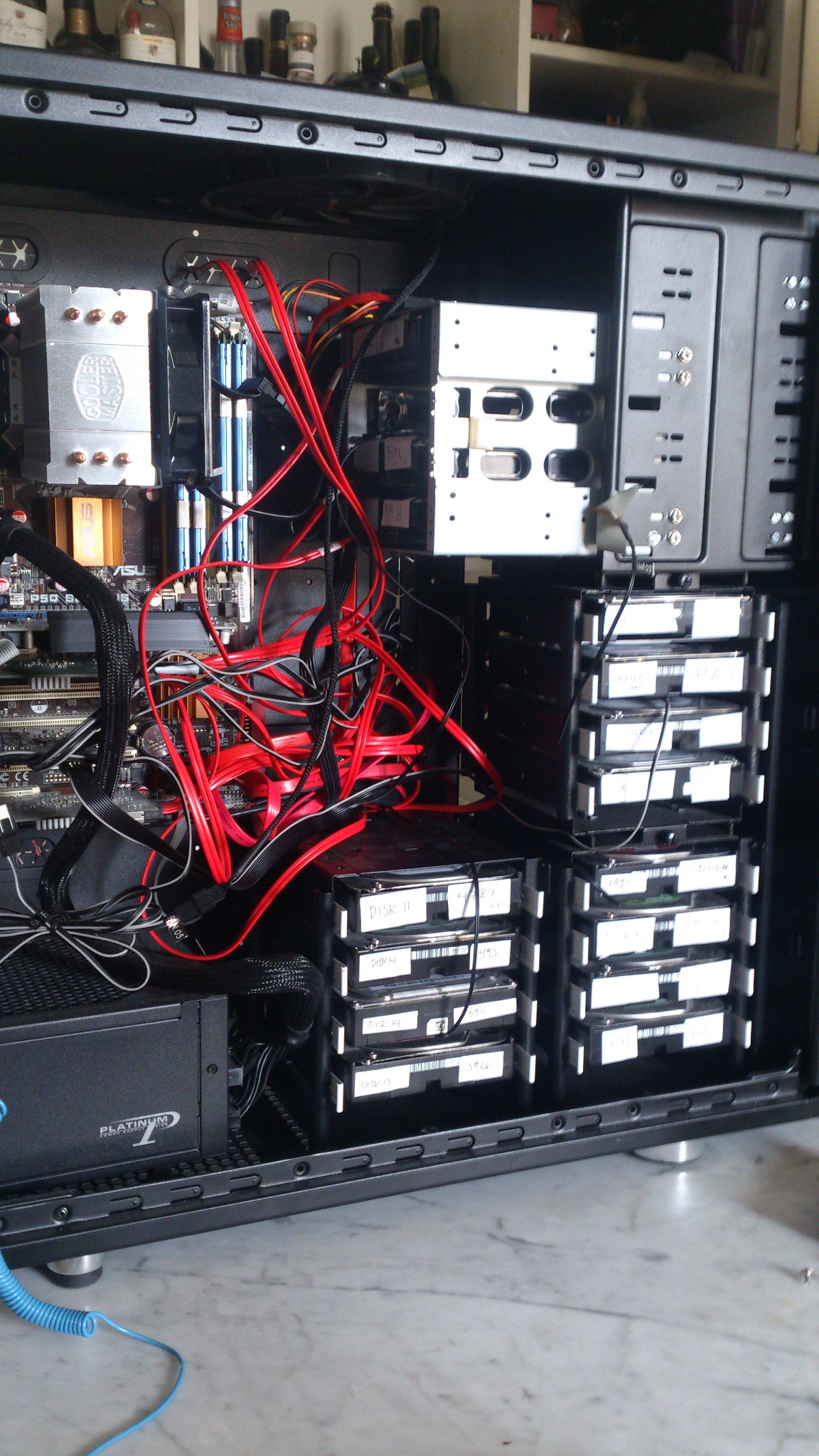

Dont suppose you still have the pics and could fix the dead links? really wanna see what this looks like as have same case
I'm currently traveling and don't have the pics along. I can fix them when I get back, but that will be a few weeks.
Found this on my phone, hope it helps!
