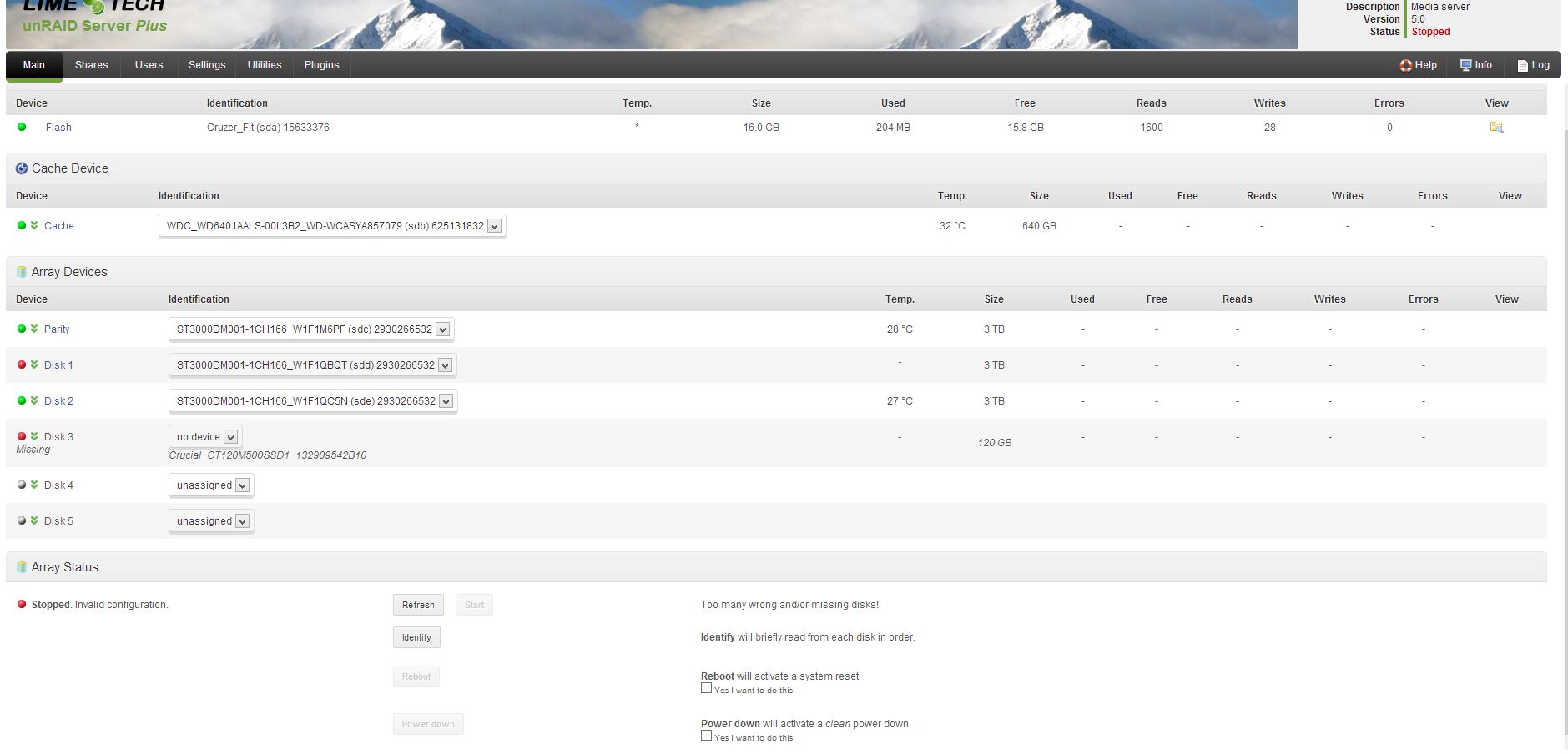

The SSD became part of the array, but I have not formatted it yet.  At the same time one of my disks now shows up as Red and is a "disabled disk".  My Parity and my other disk are both green and fine.  So I decided to unplug my SSD just because it was getting late, figuring maybe it just didn't like that SSD being part of the array and it did something to that disk.
So now it just thinks the SSD is missing instead and that disk that was spun down and disabled is still spun down and disabled...

If you have altered the contents of the SSD at all since you removed it, you lost your ability to fully recover your failed disks data unless the drive itself is really ok. You will need to put the SSD back so unraid can use it to emulate the other failed disk. Parity can only reconstruct one drive at a time, and right now you have 2 missing drives. If you put the SSD back untouched, unraid should be able to reconstruct disk1. Without it, disk1 data is gone, unless the drive itself is actually ok. The fact that you never formatted the SSD is irrelevant, unraid still uses the raw drive to calculate parity for the missing disk.
You may want to physically remove the failed disk1 and see if it is readable in another box, or just restore from your backups.
I can always put the SSD back in, but I didn't see any way to restore Disk 1 at that point either.
If the SSD is no longer listed as missing in the screenshot you posted earlier, you should be able to start the array degraded, and access the files to copy them elsewhere, or put a new disk in slot 1 and let it rebuild the data onto that. As long as more than one drive is missing, it will not allow the array to start at all. If only one drive is missing, you should be able to start the array.
