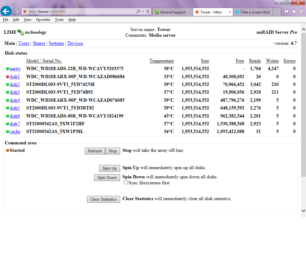

Hey guys, I moved about 8 months ago and my unRAID server has been sitting in a box. I finally took it out today and hooked it back up to my network.
I logged into the web gui and DISK1 has a red light indicator. All other lights are green.. I attached a Syslog and a screenshot of the web gui. Can someone help me why I'm getting the red light?
I am using version 4.7.
syslog.txt

That particular drive is getting READ DMA errors, which can be a few things, including a loose cable.  Being that the server was moved and has been sitting in a box for 8 months, a loose cable is the most likely culprit.  Reseat the SATA and power conectors on that drive and report back.
Also thought I should add (in case it wasn't clear) you need to reseat that particular SATA cable on the motherboard side as well, as that may be where it is loose.

In the absence of any SMART data, it's hard to say for sure.
The drive could have actually failed; or you may have had a loose cable that's hopefully now been fixed.
You can do this:
Stop the array.
Unassign disk1 (so there's no disk assigned to that slot).
Start the array -- it will show a missing disk.
Stop the array.
Assign the disk back to disk1.
Start the array -- it should now rebuild the disk (this will take many hours) ... and if the disk is otherwise okay, all should be well when it's done.
