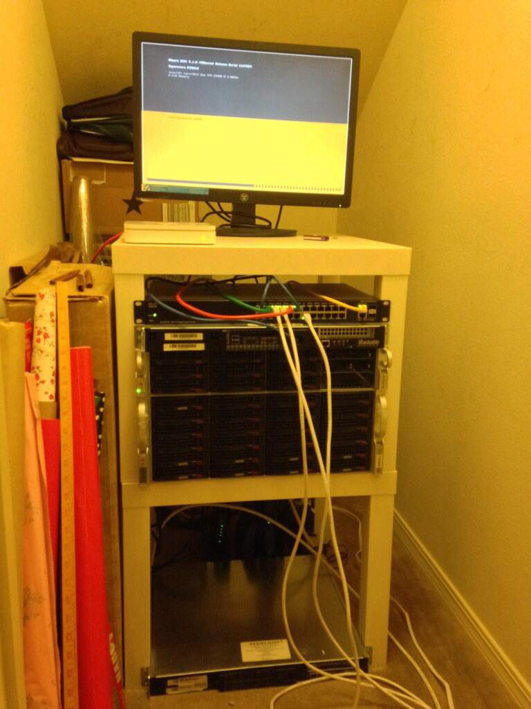

The "Lack Rack" arrangement ... mounting a rack case in an Ikea Lack side table ... is an interesting idea; but I'm not sure I'd trust the weight of a fully loaded 4U case with 24 drives.    Most of the examples have switches; audio amps; etc. mounted in them.    This is FAR less weight than a loaded X-Case server would be.    It's PROBABLY okay ... and it certainly looks neat  :)    Certainly worth giving it a shot -- the tables are only $10.
I've got a 24 and 12 drive case on a Lack Rack like this, and I don't sense any instability. (This is an old picture, most of the drive bays are filled up now, but still seems very stable)
Sent from my iPad using Tapatalk HD
It is an interesting way to mount a rack-mount cage.  I'd prefer an actual rack where I can slide the case out on the rails ... but for a very inexpensive way to mount it, the "Lack Rack" does seem to do the trick  :)
Yep brilliant idea to have another LackRack to support the weight of the XCase  :D
Yeah it's a massive pain if I need to access the insides, since I have to take everything off. But for $16 for two, I'm willing to put up with it!
Agree $16 is a nice price  :)
