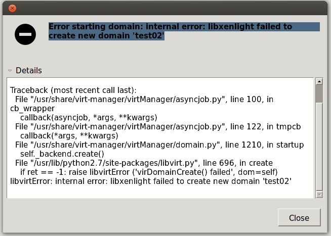

I'm having troubles installing a domU guest. My desktop is Ubuntu 13.10 and I'm able to remotely connect to my Arch dom0 build and run virt-manager. I seem to be able to use virt-manager to create a guest (using the Arch install ISO loaded locally), and it will boot; but when I try to end/shutdown the guest I see this error shown below entitled: Error starting domain: internal error: libxenlight failed to create new domain 'test01'
I've picked around reviewing the journal (logs) to see what why that error is happening, and I've probably deviated from the "straight-and-narrow" build outlined in this guide. So, I don't know if it's worth restarting from the ground up or if there's a solution. I can't seem to find anything worthwhile searching Google; and I'm not sure how to build a system directly from the terminal, sigh.....
Clues??
Try creating a cfg file and not using libvirt to make sure it works first. Then we can troubleshoot libvirt.
Following the Ubuntu instructions
OK, I was able to FINALLY create a working guest domU using a cfg file. I have to say it more involved than it sounds. I had troubles following the Ubuntu guide; for starters it wants to use LVM for the disk storage and I didn't know jack about it. Well, I did my best at trying to follow it but ultimately I switched to trying my hand at installing an Arch domU based on the new ISO.

My libvirt (virt-manager) is still not working. The one big breakthrough I had with getting my Arch domU to run was getting the right MODULES loaded in the host's (dom0) mkinitcpio.conf file and rebuilding initramfs(??). I thought it might also help libvirt, but no.
At least now with a working domU I can experiment with PCI passthrough for it. Thanks again!!
Hey, I think I'm in better shape!! I think my troubles with libvirt and virt-manager really were tied to the way I've been running my X11 sessions between the Arch/Xen server and my Ubuntu WS. I have been using the WS's built-in terminal "app" to SSH into the Arch/Xen server and by-and-large it works great. To run X sessions I learned I needed to use the command "ssh -X [email protected] and that works for most things.
With all the trouble I've had getting virt-manager to actually get a VM built, I've been going over Grumpy's guide. I thought I'd try using Putty to connect; and when I did I found I could not get a window in XTerm. I found a Putty help page and found I needed to enter 127.0.0.1:0 in the X display location.
......Oh crap, it worked once and I got cocky. Now I'm back to the "same error."
Well it's still a step forward!
