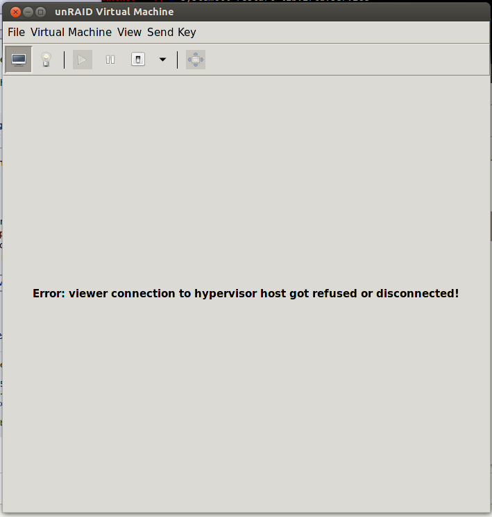

Edit1: well, after successfully running Grumpy's KVM-unRAID VM he posted in the openSUSE/KVM thread I now see a journal reference, in red, to libvirt ver. 1.2.0 (no -1) but that module is loaded. So maybe it's not a big problem. I have yet to see a consecutive successful boot of a VM through virt-manager, but my fingers are crossed.  ;)
Edit2: OK, so I got another successful boot of the KVM-unRAID VM, but on my third try, this time Arch Installer VM, libvirt crapped out (refused connection error in virt-manager's console window). This entry showed up in event log:
logger[2850]: /etc/xen/scripts/vif-bridge: brctl delif xenbr0 vif3.0 failed
attached is the error window.
"the beat goes on....."
Are you trying KVM or Xen?
If it's KVM make your Network Bridge "br0".
If it's Xen make your Network Bridge "xenbr0".

Smakovits:
What is the OS of the VM that's giving you the message? Is it able to boot, or does it hang? Was it built using Virt-Manager or from a config file (by hand, so to speak)?
