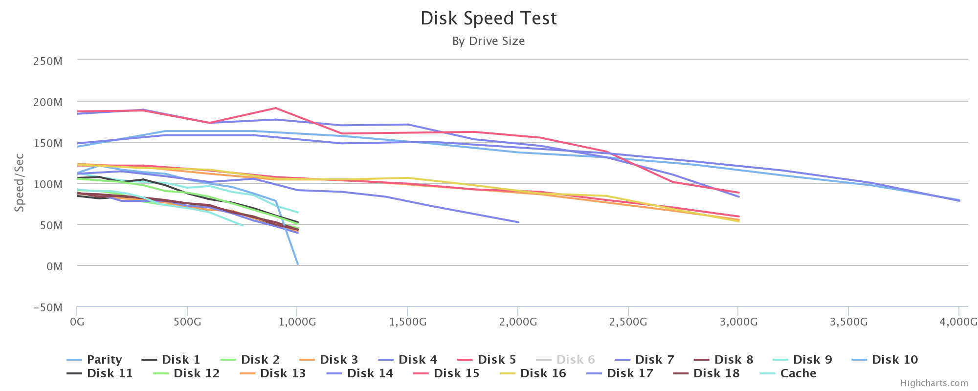

What a fantastic script.... apparently my 1 Hitachi drive and 2 Samsung drives are quite the under-performers relative to the western digital green and red drives (the red's performing best).
In case anyone is curious here are the results for my array.  I was planning on filling out my NORCO 4224 but instead I think I might start replacing disks first...

here is mine. looks like it is time to get the WDC (green) drives out and get some more of the Seagate drives in (mabye some of the enterprise level instead of consumer even)
Disk /dev/sda skipped; UNRAID boot or flash drive
/dev/sdb (Disk 12): 83 MB/sec avg
/dev/sdc (Disk 16): 96 MB/sec avg
/dev/sdd (Disk 7): 68 MB/sec avg
/dev/sde (Disk 3): 69 MB/sec avg
/dev/sdf (Disk 15): 95 MB/sec avg
/dev/sdg (Parity): 131 MB/sec avg
/dev/sdh (Disk 2): 71 MB/sec avg
/dev/sdi (Disk 1): 68 MB/sec avg
/dev/sdj (Disk 10): 94 MB/sec avg
/dev/sdk (Disk 11): 85 MB/sec avg
/dev/sdl (Disk 6): 153 MB/sec avg
/dev/sdm (Disk 13): 94 MB/sec avg
/dev/sdn (Cache): 74 MB/sec avg
/dev/sdo (Disk 17): 89 MB/sec avg
/dev/sdp (Disk 4): 153 MB/sec avg
/dev/sdq (Disk 9): 93 MB/sec avg
/dev/sdr (Disk 8): 71 MB/sec avg
/dev/sds (Disk 5): 154 MB/sec avg
/dev/sdt (Disk 14): 132 MB/sec avg
/dev/sdu (Disk 18): 70 MB/sec avg
I wouldn't discount them out of hand, they would work fine for infrequently accessed files, music, or DVD quality media which doesn't require fast data and even then, those drive should still be able to saturate your network. That said, they do increase parity speed duration and would make for good candidates when upgrading drives.

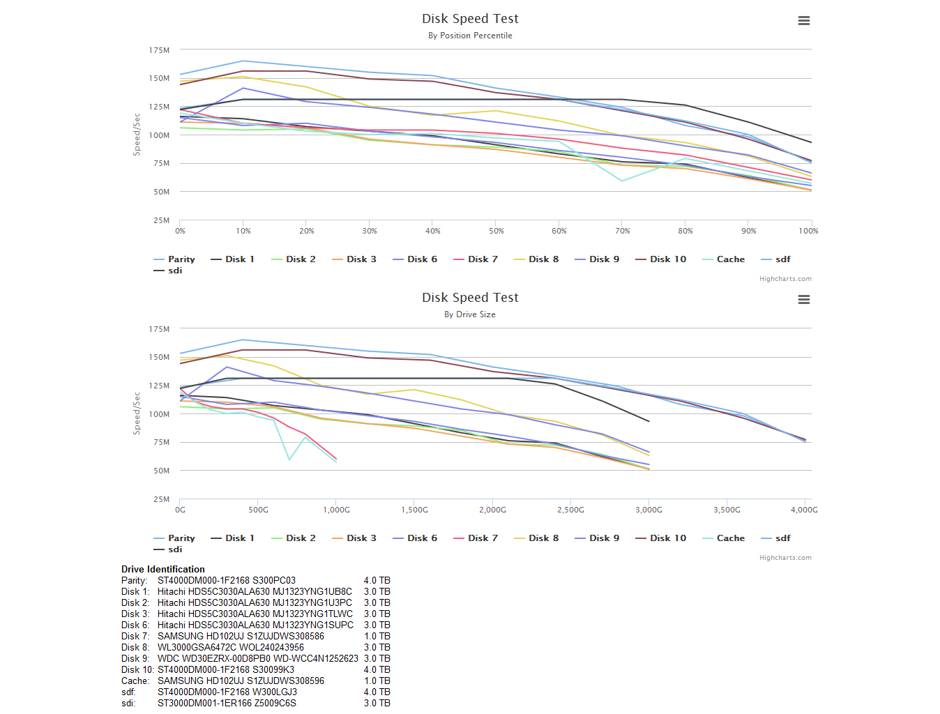

wow, i just saw this thread, and had to have a play.  Nice work, thanks for sharing.
Surprisingly, everything in my server seems to be 'not too bad'...
/dev/sdb (Cache): 89 MB/sec avg
/dev/sdc (Disk 7): 94 MB/sec avg
/dev/sdd (Disk 1): 88 MB/sec avg
/dev/sde (Disk : 113 MB/sec avg
/dev/sdf: 119 MB/sec avg
/dev/sdg (Disk 10): 129 MB/sec avg
/dev/sdh (Parity): 133 MB/sec avg
/dev/sdi: 124 MB/sec avg
/dev/sdj (Disk 2): 85 MB/sec avg
/dev/sdk (Disk 9): 106 MB/sec avg
/dev/sdl (Disk 3): 85 MB/sec avg
/dev/sdm (Disk 6): 89 MB/sec avg
