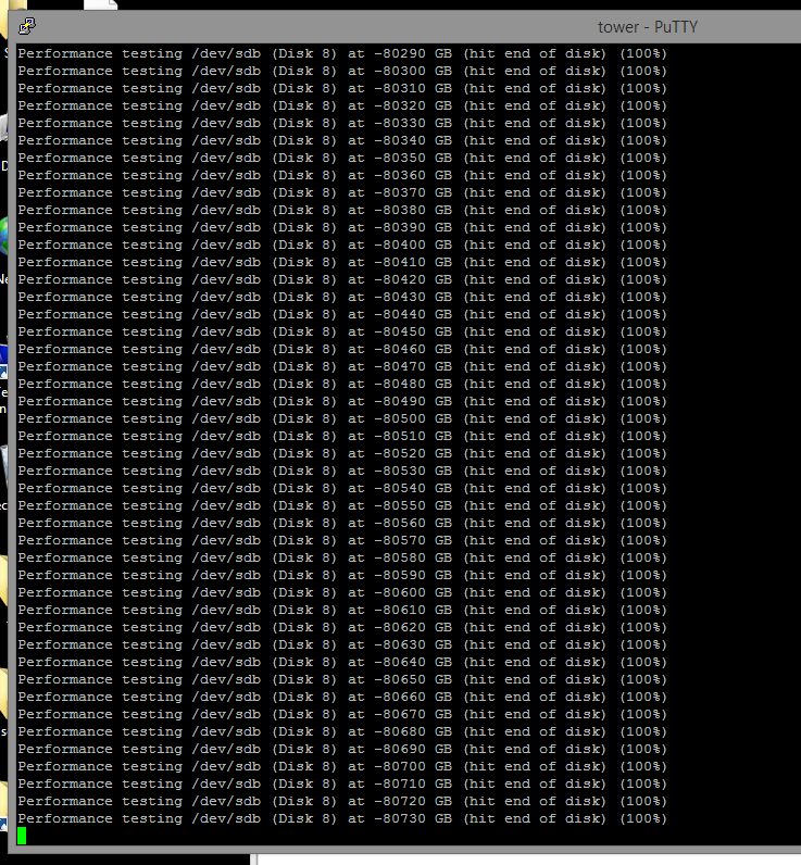

I seem to be having a similar issue, it doesn't seem to like my thin-provisioned vmdk cache "disk".  It's configured for 250GB but the script is trying to read past that
Performance testing /dev/sdb (Cache) at -309012 GB (hit end of disk) (100%)
Performance testing /dev/sdb (Cache) at -309022 GB (hit end of disk) (100%)
Performance testing /dev/sdb (Cache) at -309032 GB (hit end of disk) (100%)
Performance testing /dev/sdb (Cache) at -309042 GB (hit end of disk) (100%)
Performance testing /dev/sdb (Cache) at -309052 GB (hit end of disk) (100%)
Performance testing /dev/sdb (Cache) at -309062 GB (hit end of disk) (100%)
Performance testing /dev/sdb (Cache) at -309072 GB (hit end of disk) (100%)

I'm working on a new version that uses dd instead of hdparm. It will eliminate the rare end-of-disk bug. But if it gets into the negative values, you can stop it. It'll never finish.

Version 2.3 released, utilizes the dd command which should remove the issue people had with it failing to read a drive. Instead of reading 1GB at each location, it now reads 200MB which during my testing provided the highest read rate. This should cut down testing time by nearly 75%.

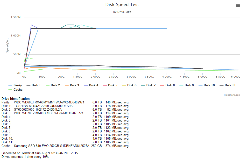

The big dip on the drive 2 at the start is charistic of Seagate drives actually performing poorly in the first 20-25 GB range.
Tests run to completion but clearly the Areca card is causing some confusion... or I have invisible warp drives lol.
Odd number too for the Seagate 6TB. I wouldn't think it was so slow.
Can you try this test version and execute it with the -l / --log option and PM/post the generated diskspeed.log file
http://strangejourney.net/Temp/diskspeed.v2.4.zip
I added logic to resolve your invisible drive issue. The log file should allow me to investigate the abnormal graphs.
Can you post the exact command line I need to run? Reduces operator errors. ;P
