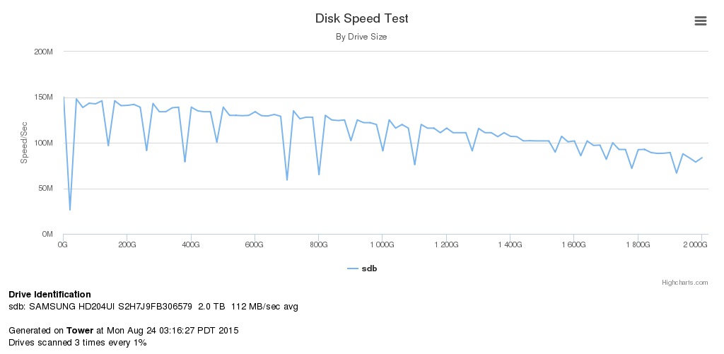

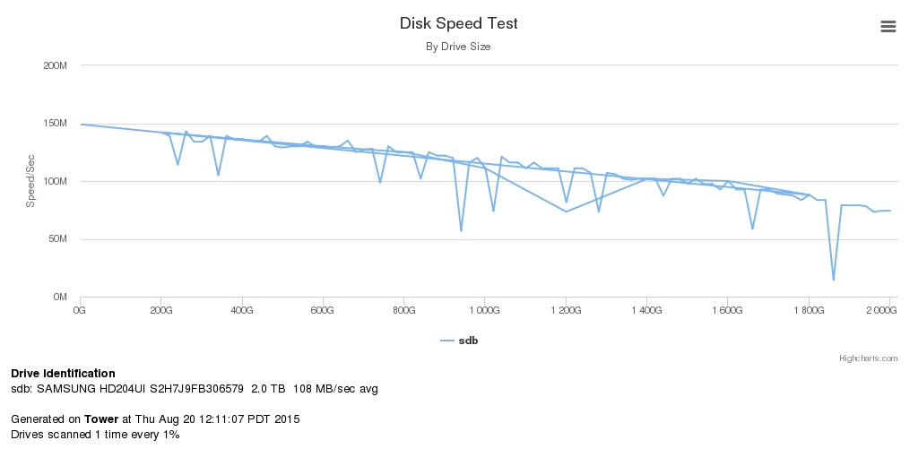

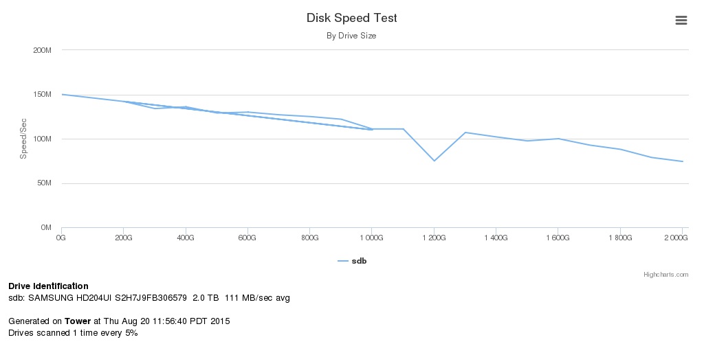

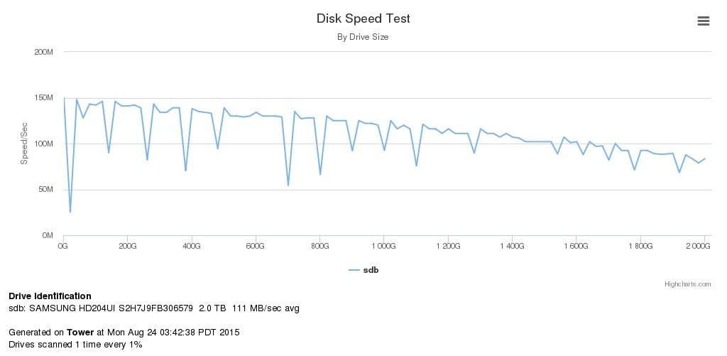

I’m trying to test a disk I know has some areas with slow sectors to see if I can see the problem in the graph, because this is usually a sign that it’s going to go bad soon and I’d like to use this test as a preventive measure on my servers, but if I try a sample value of 21 or above I get nonlinear results.
For example, for –s 21 first test is at the 1tb mark, then comes back to the 200mb mark, then 400mb and so on.
What are the max samples it should work? I’d like to use -s 101 to test by 1% increments, but when I use it the test starts at 0mb, then 200mb, 400mb and so on until 2tb, then restarts and starts again now in smaller steps so the graph is not linear.

This is fixed.

What program is this? It's possible I can duplicate this functionality and display the data in a browser using a heat map.
It's MHDD
http://hddguru.com/software/2005.10.02-MHDD/
It's a very useful diagnostic tool but it only runs from a boot cd or usb pen and it will only test HDDs connected to the onboard sata master ports set to IDE mode, it doesn't support AHCI.
I always run a pass in any new disk before using it.
It would be very cool if could create an option to do a full sector scan and show slow sectors.
Testing every 1% was enough to see the slow areas on this drive, of course this will never be the equivalent of a full surface scan but is a quick way of alerting to a possible problem, in which case I’ll do further tests.
