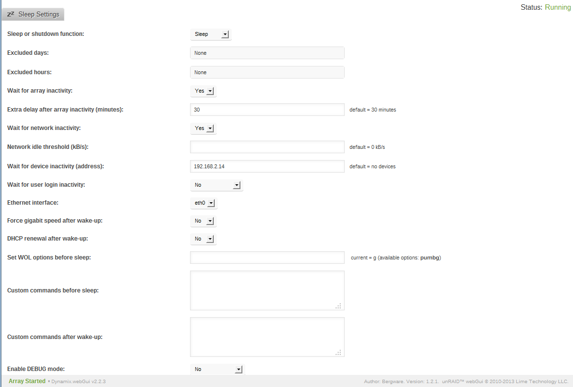

Ok, first of all thanks for the reply.
Here is the extra info:
I'm using unraid 5.0.5 with sleep plugin version 2.1.1.
A screenshot of my plugins config is attached. Note that only the device inactivity field keeps its value, if i set the idle treshold value to i.e. "20", it disappears after I click "Apply".
The error also occurs with the default settings. I have one disk outside of the array. I just installed the snap plugin and have the error with or without it.
These are the last lines of my /boot/logs/s3_sleep.log:

How are you supposed to set an excluded disk? There is no field for it in the GUI and when editing /boot/config/plugins/dynamix/dynamix.s3.sleep.cfg, neither "exclude" nor "excludeList" keep their values after applying my settings.
Well normally you should never edit the config manually. :) There should be a dropdown to select the exclude mode and a select box listing the drives outside the array. They are both missing from your screenshot. The question is why they are missing.

I checked the HTML source code and saw the input fields were present but hidden, maybe that is how it is coded on certain conditions?
<option value=''>No</option><option value='-a' selected>Yes</option>  </select></td>
  </tr>
  <input type="hidden" name="exclude" value="">
  <input type="hidden" name="excludeList" value="">
  <tr><td>Extra delay after array inactivity (minutes):</td>
  <td><input type="text" name="timeout" maxlength="2" value="30">default = 30 minutes</td>
  </tr>
Yes it is. If no drives outside the array are found, the options to exclude those drives are hidden. So far that is correct, or do you have drives outside, that are not detected?
If not, the problem is that it doesn't save your settings and gives the php error on the page when you click apply or done? The syslog itself does not show s3sleep errors as far I can tell. I'll recheck the functionality on my system and report back later. If I don't find problems on mine I'll ask you to try some more things to pinpoint the error.

Sorry for the late reply. Did some more analyzing on this and found some coding problems that need fixing. As I'm rather busy at the moment, this will take some time.
Fact is you have a disc outside the array? Then s3_sleep -ED should not display an empty line. There is a bug in there we'll have to find.
I never used idle threshold myself, so I did not notice until now. You are correct, it loses its value, so there is another bug thats needs to be fixed. Do all other values stick?
No problem, thanks for looking into it.
I do have a disk outside the array (see attached screenshot) and all other values stick.
Further testing on my system shows the idle value propably sticks too. The problem is that it does not get shown on the config page.

That seems to have done the trick. With the adjustment, I get the excluded disk form fields and applying my settings reloads the page seemingly without error.
Only thing that's left now is the network idle field that doesn't keep its value.
