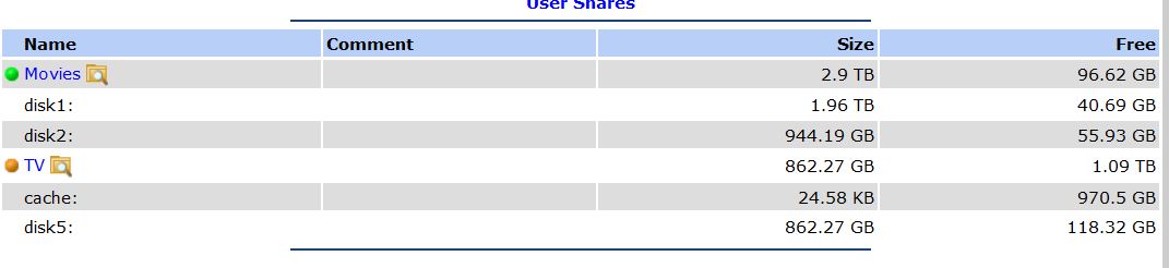

Is this, perhaps related to the use of a cache disk? I just noticed a similar behavior on my setup.
User share spans 2 disks, only 90GB free between the two, yet unRAID reports nearly 1TB free. When calculating free space from the Shares tab of the web UI it seems to include cache disk space in the free space calculation for the user share. Is that expected? It only seems to do that if there is currently a top level folder for that particular user share on the cache drive.

Here's a screen shot of what I'm seeing on 5.0.5. The Movies share does not have a top level folder on the cache drive currently. The TV share does.
Clearly it's reporting the free space on the cache drive as available space.
That is an error in the reporting -- not an extra 1TB of "magically available" space.
