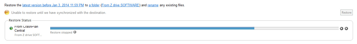

There is another downside to all of this. If you have a large restore to do, like I did, I'm talking over 250GB and once you get Crashplan to start the restore it takes so long that once it tries to start syncing again it will fail that restore and come back with an error saying "unable to restore until we have synchronized with the destination again".
Then when you try to contact crashplan about all this they try to sell you their RESTORE TO DOOR service which costs you $164. They will restore your files onto a hard drive and ship it to you. I told them I want support for a restore I'm trying to do and they consistently said I'll have to do the RESTORE TO DOOR service and pay up. I'm a little taken back at all this, since a lot of people use Crashplan but truly never have to do really large restores. Not until you have to do a large restore with many files do you really notice how bad their service really is. Yep, they'll backup everything in the world for you, terabytes even, but go ahead and try to perform a really large restore with many folders and files. I'm on a 50Mb connection and connect to the newsgroups and download 6MB/sec easily at a constant rate. I'll be lucky to get 300KB/sec download speeds out of Crashplan. I'm not saying don't use their service, but just let it be known about issues like this.

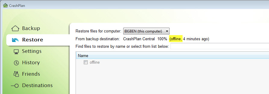

Here are some screen shots of the errors.
I think you can tune the settings a bit to avoid the resync problem, but it is a shame that Code42 (Crashplan) wont help you do the tuning. Overall I think you are spot on. Crashplan works great for laptop and desktop protection, but it does not work so good for multi terabyte storage arrays. In my test, I selected 16 files to restore. In real life, I may have needed all 16, but I would know which one or two were needed first, etc. Thus restore can be broken into stages.
