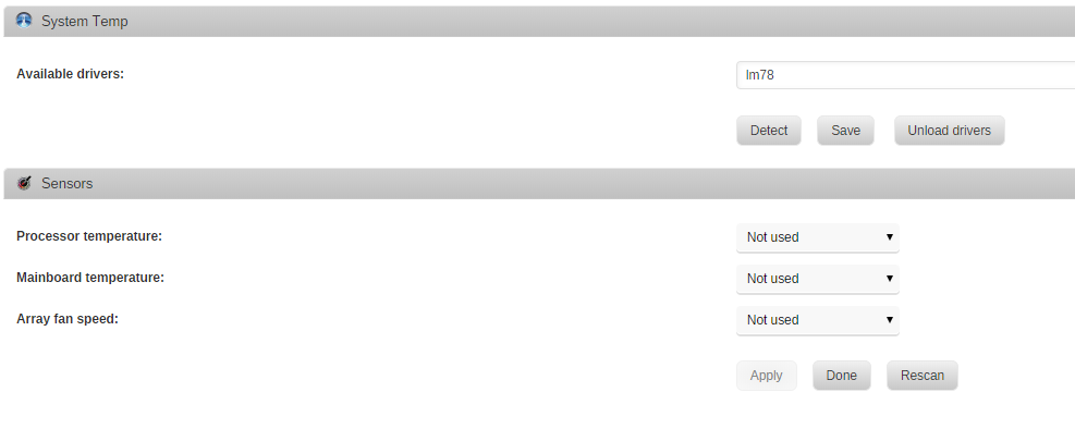

Is this no longer working on the 6.4 betas? My modules are coretemp and jc42. Available sensors will sometimes show up in the drop down box (not usually), but when I attempt  to save the selections, they revert back to Not used.

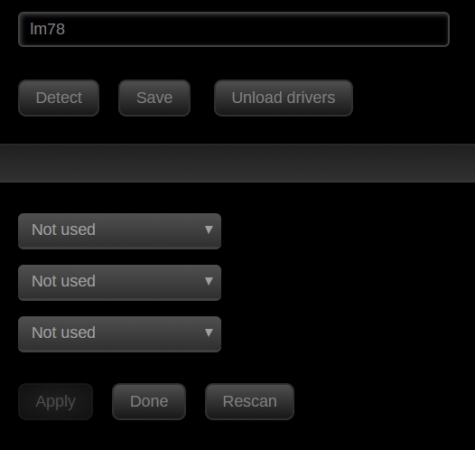

I can't get any info with my config. Anyone has a way to fix it?
Thx!
Unraid version 6.4.0_rc15e
CPU = AMD Ryzen 1700X
MB = ASUS Prime B350-Plus AMD Ryzen AM4
Detected sensor = lm78

Hi, I'm having trouble with this, I installed perl via nerdpack, I installed the plugin, clicked detect, it found the lm78 driver, and then it could not detect any temperature/fan things. All the dropdowns don't have any options in them. Not sure what to do. I saw this, wondering if I need to update lm_sensors and install it87. Can someone advise me on how to do that, since I can't seem to find any package manager or even GCC in Unraid. Thanks!
Type IT87 where LM78 is and click save. then check the drop downs.
Doesn't work for me.

35 minutes ago, Jack Skellington said:
# sensors-detect revision 6284 (2015-05-31 14:00:33 +0200)
# Board: ASUSTeK COMPUTER INC. PRIME B350-PLUS
# Kernel: 4.14.26-unRAID x86_64
# Processor: AMD Ryzen 7 1700X Eight-Core Processor (23/1/1)
This program will help you determine which kernel modules you need
to load to use lm_sensors most effectively. It is generally safe
and recommended to accept the default answers to all questions,
unless you know what you're doing.
Some south bridges, CPUs or memory controllers contain embedded sensors.
Do you want to scan for them? This is totally safe. (YES/no):
Silicon Integrated Systems SIS5595...                       No
VIA VT82C686 Integrated Sensors...                          No
VIA VT8231 Integrated Sensors...                            No
AMD K8 thermal sensors...                                   No
AMD Family 10h thermal sensors...                           No
AMD Family 11h thermal sensors...                           No
AMD Family 12h and 14h thermal sensors...                   No
AMD Family 15h thermal sensors...                           No
AMD Family 16h thermal sensors...                           No
AMD Family 15h power sensors...                             No
AMD Family 16h power sensors...                             No
Intel digital thermal sensor...                             No
Intel AMB FB-DIMM thermal sensor...                         No
Intel 5500/5520/X58 thermal sensor...                       No
VIA C7 thermal sensor...                                    No
VIA Nano thermal sensor...                                  No
Some Super I/O chips contain embedded sensors. We have to write to
standard I/O ports to probe them. This is usually safe.
Do you want to scan for Super I/O sensors? (YES/no):
Probing for Super-I/O at 0x2e/0x2f
Trying family `National Semiconductor/ITE'...               No
Trying family `SMSC'...                                     No
Trying family `VIA/Winbond/Nuvoton/Fintek'...               No
Trying family `ITE'...                                      Yes
Found unknown chip with ID 0x8655
    (logical device 4 has address 0x290, could be sensors)
Probing for Super-I/O at 0x4e/0x4f
Trying family `ITE'...                                      No
Some systems (mainly servers) implement IPMI, a set of common interfaces
through which system health data may be retrieved, amongst other things.
We first try to get the information from SMBIOS. If we don't find it
there, we have to read from arbitrary I/O ports to probe for such
interfaces. This is normally safe. Do you want to scan for IPMI
interfaces? (YES/no):
Probing for `IPMI BMC KCS' at 0xca0...                      No
Probing for `IPMI BMC SMIC' at 0xca8...                     No
Some hardware monitoring chips are accessible through the ISA I/O ports.
We have to write to arbitrary I/O ports to probe them. This is usually
safe though. Yes, you do have ISA I/O ports even if you do not have any
ISA slots! Do you want to scan the ISA I/O ports? (YES/no):
Probing for `National Semiconductor LM78' at 0x290...       Success!
    (confidence 6, driver `lm78')
Probing for `National Semiconductor LM79' at 0x290...       No
Probing for `Winbond W83781D' at 0x290...                   No
Probing for `Winbond W83782D' at 0x290...                   No
Lastly, we can probe the I2C/SMBus adapters for connected hardware
monitoring devices. This is the most risky part, and while it works
reasonably well on most systems, it has been reported to cause trouble
on some systems.
Do you want to probe the I2C/SMBus adapters now? (YES/no):
Found unknown SMBus adapter 1022:790b at 0000:00:14.0.
Sorry, no supported PCI bus adapters found.
Module i2c-dev loaded successfully.
Next adapter: SMBus PIIX4 adapter port 0 at 0b00 (i2c-0)
Do you want to scan it? (YES/no/selectively):
Client found at address 0x52
Probing for `Analog Devices ADM1033'...                     No
Probing for `Analog Devices ADM1034'...                     No
Probing for `SPD EEPROM'...                                 No
Client found at address 0x53
Next adapter: SMBus PIIX4 adapter port 2 at 0b00 (i2c-1)
Next adapter: SMBus PIIX4 adapter port 3 at 0b00 (i2c-2)
Next adapter: SMBus PIIX4 adapter port 4 at 0b00 (i2c-3)
Now follows a summary of the probes I have just done.
Just press ENTER to continue:
Driver `lm78':
  * ISA bus, address 0x290
    Chip `National Semiconductor LM78' (confidence: 6)
Do you want to generate /etc/sysconfig/lm_sensors? (yes/NO): y
Copy prog/init/lm_sensors.init to /etc/init.d/lm_sensors
for initialization at boot time.
You should now start the lm_sensors service to load the required
kernel modules.
Unloading i2c-dev... OK
Do I need to copy prog/init/lm_sensors.init to /etc/init.d/lm_sensors ?
