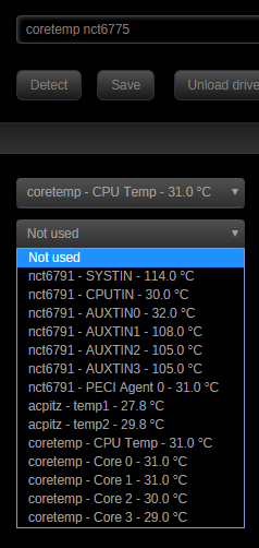

my current setup as follows
H87I-PLUS with latest BIOS
unraid 6.5.0
a few temps are over 100 C and i'm trying to figure out which one is the correct mainboard temp. after some google search it appears that SYSTIN is apparently the mainboard temp. what concerns me a bit is that it's stuck at 114 C. i'm guessing the sensor is wrong because nothing in my pc smells like it's burning.
would it be safe to assume that maybe CPUTIN or AUXTIN0 or PECI agent 0 is the correct mainboard temp?
any help would be appreciated. thanks in advance.
It's very hard with temperatures, because you need to know what offset and/or scale you need to configure for the different inputs to get them to translate the raw measurement into an actual temperature. Best would be if you could find someone else with same motherboard and a posted configuration file that contains the configuration values for the nct6791 sensor.
I wish the motherboard manufacturers could have been nice and post these translation figures to make it easy for Linux users to measure temperatures and voltages instead of having to depend on the manufacturers often Windows-only tools.

I have now modified the sensors.conf file located on the flash drive at config/plugins/dynamix.system.temp in hopes that on reboot it will load properly. Using the "rescan" button on the System Temp page now shows me my temps!!!! I am also seeing FAN SPEEDS! First time for that one :) Any chance we could maske that page display more entires, I have a bunch of fans in this box lol.
Aww crap, as soon as I "apply" it all goes away :( the config file is rewritten when I hit the Apply button. Is there a way to solve this?
Ha, manually edited it again, hit rescan, applied what I want, and instead of hitting Apply hit Done and was able to keep my temps - woohoo!
The same thing is happening to me on the same board. If I pull the flash drive and delete the dynamix configs it detects but when I select my sensors and hit apply all sensors go to Not used. I SSHed into the server and tried the sensors command and got the same error you did.
I tried to find the files in etc/sensors.d but it doesn't exist in my etc folder... Im using dolphin to browse root/etc.
I know im just dumb but I cant figure it out and I really need to get the temp output to use auto fan to try and save some power these supermicro fans are staying on full even when I ipmi into the board and switch to optimal. Thanks

Same issue, with Supermicro board.
Can somebody help me with sys temp on ASUS Strix X370, I have unRAID 6.5.3 and the it87 driver seems still outdated, because I can not detect any sensors with the plugin.
the guide from
is no longer valid, because the github source was removed as of 1st August 2018. If someone could share a copy of their own, that would be welcome.
ANSWER:
just set the driver to IT87 and hit save, that should work.
the git repository of the driver is cloned here: link to AUR

In system temp plugin try typing in it87 in the available driver and loading it and see what comes up?

Type it87 in the available driver section and hit load driver.
Seems to work, but the error message still remains on every boot, which makes me “nervous”.

I've been trying to use this plugin for a while on one of my servers I always get the following:
Jan 30 11:48:28 Tower kernel: i2c /dev entries driver
Jan 30 11:48:33 Tower kernel: i2c i2c-0: found f75373 version: 20
Jan 30 11:48:33 Tower kernel: f75375 0-002d: hwmon_device_register() is deprecated. Please convert the driver to use hwmon_device_register_with_info().
Jan 30 11:48:33 Tower kernel: i5k_amb i5k_amb.0: hwmon_device_register() is deprecated. Please convert the driver to use hwmon_device_register_with_info().
Jan 30 11:48:33 Tower kernel: w83627hf: w83627hf: Found W83627HF chip at 0x290
Jan 30 11:48:33 Tower kernel: w83627hf w83627hf.656: hwmon_device_register() is deprecated. Please convert the driver to use hwmon_device_register_with_info().
Jan 30 11:48:33 Tower kernel: w83793 0-002f: hwmon_device_register() is deprecated. Please convert the driver to use hwmon_device_register_with_info().
Jan 30 11:48:33 Tower kernel: w83793 0-002f: Registered watchdog chardev major 10, minor: 130
If I go and manually try and run sensors I get this after the plugin has finished its detect:
Error: File /etc/sensors.d/sensors.conf, line 2: Undeclared bus id referenced
Error: File /etc/sensors.d/sensors.conf, line 4: Undeclared bus id referenced
Error: File /etc/sensors.d/sensors.conf, line 14: Undeclared bus id referenced
Error: File /etc/sensors.d/sensors.conf, line 16: Undeclared bus id referenced
sensors_init: Can't parse bus name
I have removed, tried commenting out the lines with issues and I can get sensors to work properly at command line, but not in the plugin...
Any ideas?

I got the temp working and then the probes was gone and I haven't been able to get them back?
I just got the new Gigabyte motherboard C246-WU4 supporting the new Intel’s Xeon E-2176G
and sofar its been working great with UNRAID
I have deleted the plugin and re-installed it but havent been able to get the sensors back again?
Running the command: root@Tower:~# sensors-detect got the below output.
And yes I have also tried to go through the https://wiki.unraid.net/index.php/Setting_up_CPU_and_board_temperature_sensing

try hitting the detect button in the plugin settings page. if that does not work, try in the text field just "jc42" and hit save (no coretemp). there should be only name of the driver, I believe that the driver name is not "coretemp jc42".
hope that fixes your problem
