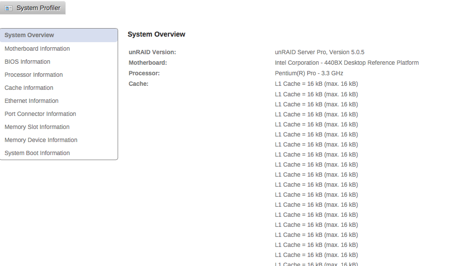

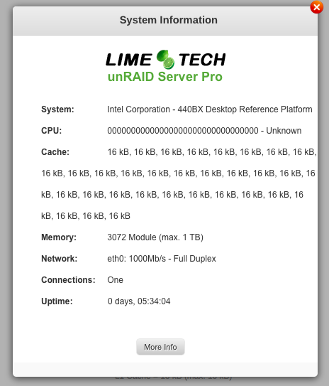

hi, I just wanna report different between Dynamix stat and Unmenu sysinfo
I'm using
Intel Xeon 1230v2
Asrock H77 Pro4 MVP
I run unraid as ESXI guest, so this maybe the cause :P
but Dynamix report I'm using Pentium PRO 3.3Ghz while Unmenu report correctly that I'm using Xeon 1230v2.
It doesnt effect anything and I dont care much about it..but I thought you might want to know.
I'm guessing Dynamix saying that I'm using Pentium PRO is due to that Family Member:6
