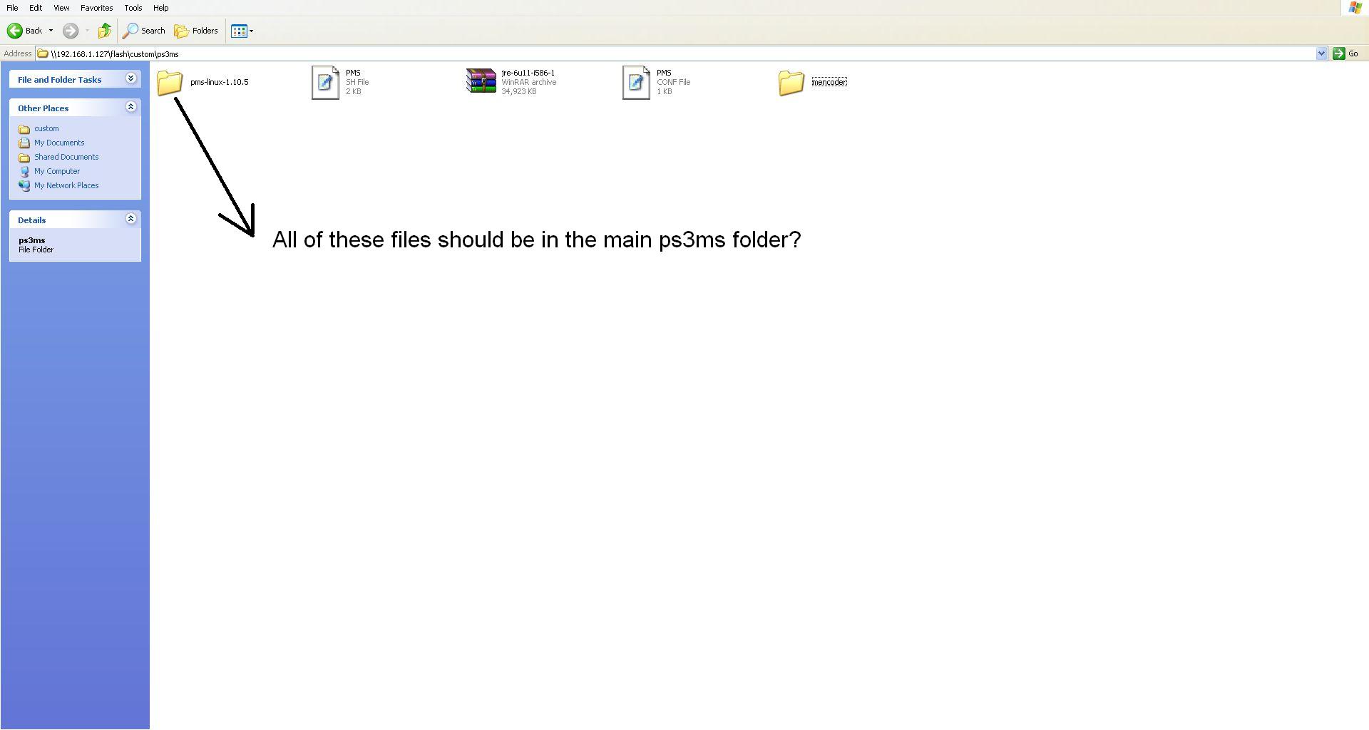

Unable to access jarfile /boot/custom/ps3ms/pms.jar
Have you checked the file exists in your ps3ms folder?  It should come from the stage when you extracted pms-linux-1.10.5.tgz, it should be in ps3ms and not in a pms-linux-1.10.5 subfolfder.
Should all of the pms-linux-1.10.5.tgz files be in the ps3ms folder or just the pms.jar?
All of them should be in there
