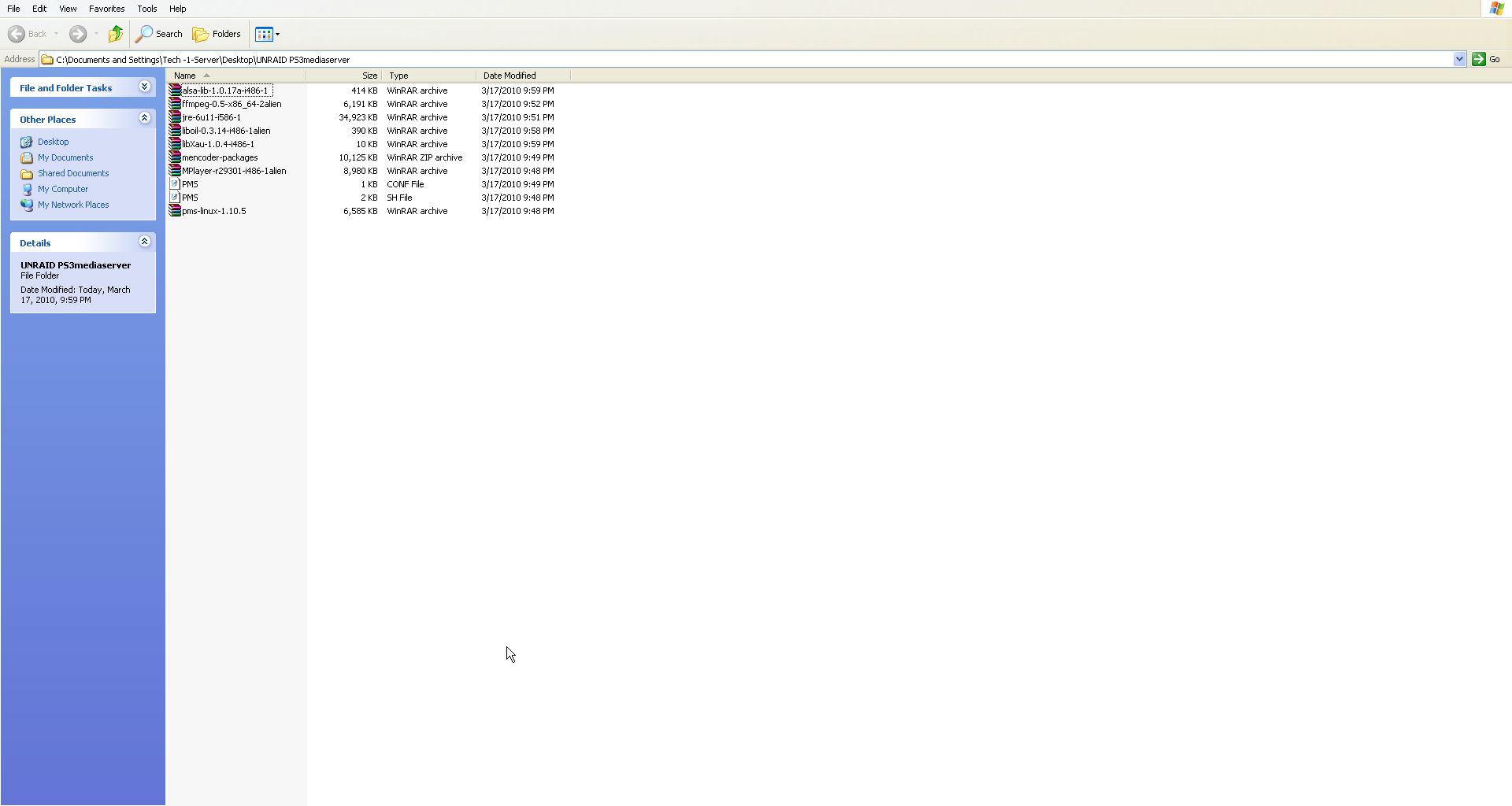

Did you use the i486 package versions instead of the x86_64's?
When you unzip the pms-linux-1.10.5 you have to unzip the .tar file that's inside it into your p3ms folder.
Also add the files vwalien mentioned in his previous post to the mencoder folder.
I deleted all the files from the custom/ps3ms/mencoder folders - I downloaded all the files even the vwalien 3 files all onto my windows xp computer into a folder, Now you mention - Did you use the i486 package versions instead of the x86_64's?  See my folder screenshot in XP I have like 4 different i486 files so now I am getting really confused :-[
I have not unzipped any files to my flash drive custom/ps3ms/mencoder folders yet...... they are all sitting in my XP folder per i am confused again......
Aj
Ok got it - I hooked up a monitor to view the messages and it said that Java had no such file/ directory - I kept unzipping the jre-6ull-i586-1.tgz instead of just placing it in the folder, Now time to test with the PS3,,,,
