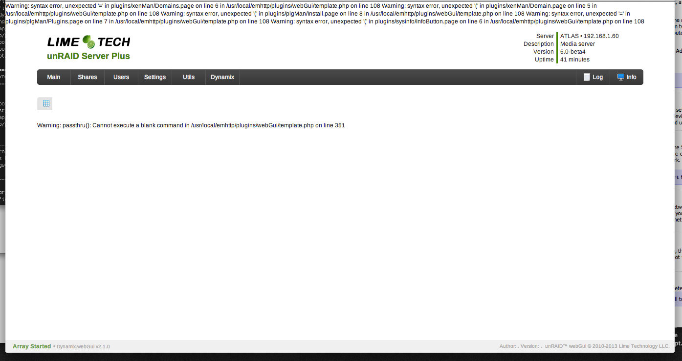

ouch..
Any ideas? It broke on 6beta4
GUI is pretty dead.. how can i uninstall?

ouch..
I got the exact same thing on my install and now it's hosed.  When I was telenetted into my system to install the webgui I copied and pasted the first part and then it was installing and telnet crashed.  Telnetted back in ran it again, crashed, now system comes up exactly like what ryan's screenshot looks like.
The changes made to unRAID 6 beta 4 have made Dynamix incompatible. Suggest everyone on 6b4 just remove Dynamix until it is updated.
To remove Dynamix, go into /boot/plugins and /boot/config/plugins and delete all files and folders that begin with Dynamix. Stop the array. Reboot.
OK. I can confirm removing the files works.. but does reset the gui, so any changes you've made to the layout configuration is lost.
