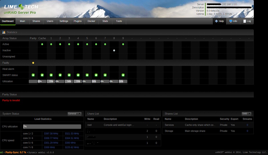

I am also on v6b10a and all I did was go to the Dynamix site (https://github.com/bergware/dynamix/tree/master/unRAIDv6) and look inside the text of each plugin and copied the URL inside and installed if from there.
Example for the WebGUI: https://raw.github.com/bergware/dynamix/master/unRAIDv6/webGui.plg
So now I have WebGui, Active Streams, Cache Dirs, Disk Health, Email Notify, System Info, System Stats and System Temp installed and all are running fine.

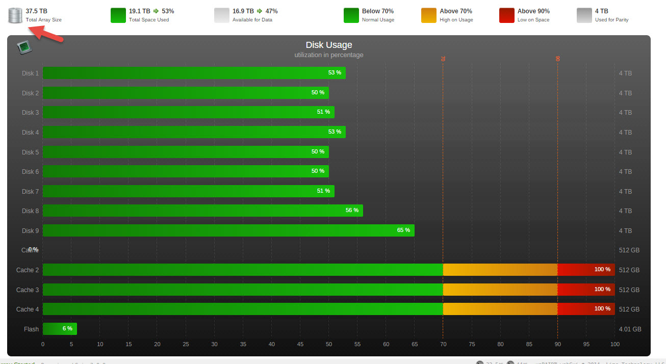

One concern and that is with the System Stats - Disk Usage for the Cache Pool. I have 4 SSDs for my cache pool, the first disk show 0% usage and for disk 2, 3 and 4 it shows 100%. Actually my cache pool is using 32Gb out of 2TB.
Also the total size seem to be off a bit - not sure what it counting. My array total is 36TB, where the System Status is reporting 37.5TB. It may be counting the cache pool as well.
I know that these plugins are still being worked on, I am just giving feedback at this point.
All these plugins are still under constructions, not final yet.
StanC: can you share your disks array content (see Tools -> Vars), that would help me correcting the stats calculations.
Do you need the whole content of the Vars or just a portion?
I have captured just the Disk Array variables and they are attached. If need more from the Vars file let me know.
Disk_Array_Vars.txt

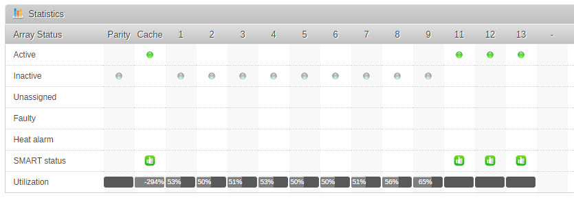

On the dashboard page I noticed that drives 11, 12 and 13 are showing. I do not have those drives in my system. I only have 10 data drives and 4 cache drives (cache pool). Could it be that it is mapping the additional cache drives as these?
Thanks for the disks info, it allows me to make the necessary corrections in 'stats' and 'dashboard'.
