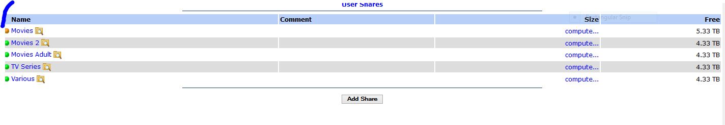

Here's some more info- I noticed my movies share is orange (see picture). First time it's been orange was last night after adding the cache drive and the disk 2. It also reads 1 TB bigger than the rest of the shares. My cache drive is 1 TB.
This morning the movies share was back to green, and reading the correct free space. After I started the test rip (IOW spun up drives) to the movies share it went orange again and the free space jumped 1 TB.
Other things I did last night when adding the disk 2 and cache drive - - dropped down from split level 2 to 1 on most shares. Increased min. free space from 0 to 60000000 (60GB) on the movie share. Added a movies 2 share for testing only after I started having slow txfr speeds.
The share will show orange when there is data on the cache drive for that share that has not been moved yet.
The free space is including your cache drive size in the calc for total size.
After the cache mover runs overnight, the share will then show green after the data is moved to the array drive.
All of this is normal when using a cache drive.
That specific behaviour (orange drive) is on purpose. It indicates there is content in the share that is currently on the cache drive, and therefore not protected by parity. When the mover script runs overnight, it cleared out the cache and put the files on the protected array, and the indicator turned green. The free space thing is something that Tom has been dealing with on and off, it's showing the protected share size + the cache drive, until the cache drive is cleared off by the mover. That is by design, and it's been debated whether or not it's the best way to handle the space available on the cache drive.
