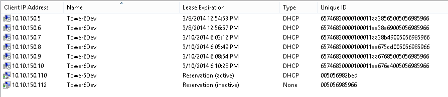

Tom have a bug for you.
It didn't occur to me at first, but everytime I rebooted v6b3 (default boot not XEN) on physical HW or Virtual Machine I received a different IP from DHCP (should not be the case as the lease wasn't expired, but dint think anything off it at first). So later on I decided to make a DHCP reservation on the mac address (like i have for a dev v5 vm), thats when I saw the problem.
v6b3 generates a new mac address (unique identifier) with each reboot and it isnt the traditional six groups of two hexadecimal digits, its 36 hexadecimal digits in total? The console shows the 12 hexadecimal digits (for eth0) but thats not what is being transmitted. The last 12 digits of the 36 digit Unique Identifier is the mac address of the nic.
See screenshot of the v6b3 vm on my dev vlan 10.10.150.x
See screenshot of the v6b3 physical host on my prod vlan
Secondary (i think), I wondered what if I release the dhcp address and renewed it, that worked so it generates a new Unique Identifier only per reboot. But while testing a release/renew 'dhcpcd -n' on v6b3 it brings up other network interfaces (gre0, ip_vti0, tunl0) that are hidden/dormant upon first booting up and show them self upon issuing the command:
Default boot (not Xen)
I brought a new v6b3 test box online today and I too noticed this issue.
Quite now you mention it this is a problem in my vmware test box. Assumed it was a vmware gotcha but sounds like it isnt
Right, I've noticed some strange things with MAC addresses as well - but haven't really looked into yet.  I am going to release -beta4 and then I have to release 5.0.6, and then I can get to this.
I do have a theory though: I think it has to do with the bonding driver.  When you have two or more NIC's bonded then the bonding driver is going to "appropriate" the MAC address of whichever ethernet port comes on-line first.  This creates a race condition and results in differing MAC addresses getting assigned at boot time.  Probably there's a way to configure bonding driver to always prefer a certain MAC address.
The dhcpcd -n command I think is also trying to renew on "all" network I/F's (/etc/rc.d/rc.inet1 invokdes dhcpcd with a single explicit port).  Probably you shouldn't use 'dhcpcd -n' unless you also specify a port, e.g., 'dhcpcd -n eth0'.
Anyway, thanks for posting this & as mentioned earlier, I'll be able to look at it after these releases get out.
