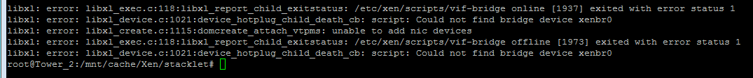

I get the following error when I try to create the VM...
Any ideas? This on a ASROCK Z87 Extreme6 with a 4770 cpu....Haswell
Did you make sure to turn on the bridge under Network settings and name the bridge xenbr0?

That did it, so simple !! Thanks.

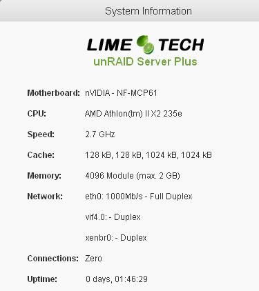

Just want to confirm that I got the beta 3 working per Tom's instructions.
Hardware on my test server per the picture attached, I had to upgrade to 4Gb of RAM since the initial 2Gb were not enough for Xen.
