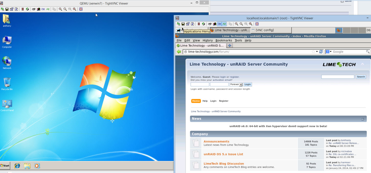

I have Windows7 up and running. Below is my config. Watch out for copy/paste errors that convert ASCII " and ' into unicode slanted versions. I have SageTV installed, and recording from a HDHomeRun network tuner. Yay!
# Documentation for the settings is here: http://xenbits.xen.org/docs/unstable/man/xl.cfg.5.html
kernel = '/usr/lib/xen/boot/hvmloader'
builder = 'hvm'
vcpus = 4
memory = 4096
# This causes Windows boot to stall at the "Starting Windows" boot screen.
#shadow_memory = 8
device_model_version = 'qemu-xen-traditional'
#disk = [
#  'file:/mnt/vms/windows/disk.img,ioemu:hda,w',
#  'file:/mnt/vms/windows/windows7.iso,ioemu:hdc:cdrom,r'
# After installation...
disk = [ 'file:/mnt/vms/windows/disk.img,ioemu:hda,w' ]
name = 'windows7'
#vif = [ 'type=ioemu, bridge=xenbr0' ]
# I let xen generate one using the blank vif spec. Then after the VM started, I grabbed the MAC address and saved it here for
# next time.
#vif = [ '' ]
vif = [ 'mac=00:16:3e:4d:0f:48' ]
on_poweroff = 'destroy'
on_reboot = 'restart'
on_crash = 'restart'
# boot on floppy (a), hard disk (c) or CD-ROM (d)
# default: hard disk, cd-rom, floppy
boot = 'dc'
acpi = 1
apic = 1
#viridian = 0
#xen_platform_pci = 0
sdl = 0
vnc = 1
vnclisten = '0.0.0.0'
# Force it to 5901. So connect to port vnc://dom0ip:5901/. Use raw encoding!
vncdisplay = 1
vncpasswd = ''
stdvga = 1
videoram = 16
usb = 1
usbdevice = 'tablet'
soundhw = 'sb16'
#serial = 'pty'
localtime = 1
Some notes:
- Set the MAC address in the cfg and DHCP allocation in your router otherwise your IP will change (even without a reboot).
- I've seen posts that say that setting viridian to 1 will avoid some VM crashes. So far I haven't seen a crash.
- Use VNC during installation, then enable remote desktop in the VM and use RDC.
- set videoram and stdvga so that you can raise the screen resolution
- set localtime to get your time zone correct
- Don't use shadow_memory. At least it caused Windows to sit indefinitely at the glowing windows screen during boot
- I have an SSD for my VMs, and this in my "go" script: mount /dev/sdb1 /mnt/vms. I plan to figure out how to find the device using some unique ID, in case it ends up being something other than sdb1 after switching things around. (Help on that is welcome!)
