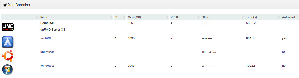

Attached is a shot of all my VM's and status.  I'm not sure what "State" means, nor why archVM is different from the others, but I'm sure it's fine ;)
The biggest on is boot 'dc', instead of his boot 'cd'
I understand the boot..  that's just setting the boot priority, so when you were set to "cd" it was booting off of an empty hard drive, and failing, but with "dc" it was picking the CD image first, so the install could complete..

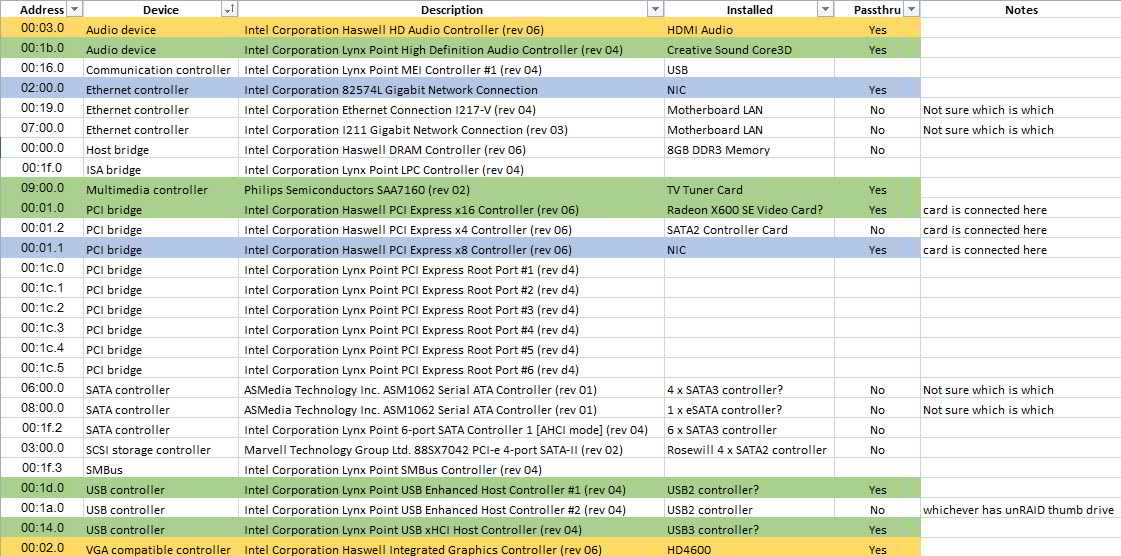

I'm starting to work on PCI passthru, but have to figure out what all the addresses of the components are first.  unRAID shows a list of all the PCI components, but I have to translate that into useful information before I proceed.
I've got the windows VM installed and running.  I've managed to install all windows updates and the gplpv drivers.  So far, so good.
Now, I want to try passing thru some PCI stuff, so windows has direct access to my...
TV Tuner
USB controller (keyboard, bluetooth mouse)
Video card (prefer the iGPU - HD4600, but assume I can only get the PCI card at this point - Radeon X600 SE)
Intel NIC
HD Audio (Creative Sound Core3D)
I think I have figured out which PCI addresses go with which devices, but I'm not sure if I need to pass i.e. the PCI slot AND the NIC to the VM, or if I just need to pass one of the 2 alone.
Attached is my PCI list, from unRAID, along with my analysis of what they are.  I'm not sure about all of these, so any suggestions on which to passthru are most welcome.
My plan was to start with this...
# VGA Passthrough Radeon X600 SE Video Card PCI Express x16 VGA card.
pci = [ '00:01.0' ]
# PCI Passthrough Creative Sound Core3D Device.
pci = [ '00:1b.0' ]
# PCI Passthrough of some USB Controllers.
pci = [ '00:14.0' , '00:1d.0' ]
# PCI Passthrough of Intel NIC
pci = [ '02:00.0' ]
# PCI Passthrough of TV Tuner Card
pci = [ '09:00.0' ]
Which didn't prevent Windows from booting, but I don't think everything passed thru correctly.  I've attached screenshots of Device Manager inside the Windows VM.  I'm still connecting to this VM with TightVNC from my laptop; not sure if that matters.
I'm not sure  where I've gone wrong, or how to perhaps better determine exactly which PCI addresses need passed thru.  I'm certainly open for suggestions.

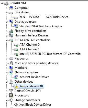

I just made good progress on passing thru a few devices to my Windows 7 VM, and all devices were recognized and Windows automatically installed all drivers.
However, I still have the same Xen pci device #0 with the yellow warning triangle showing up in device manager.
One of the devices I passed thru was a single USB device (ASMedia Technology Inc.), which is actually my USB3 controller, like so...
usbdevice = [ 'tablet','host:174c:3074' ])
This, in turn passed my wireless mouse dongle, a bluetooth dongle and an external hard drive I have connected to my USB3 slots.
The other things I passed thru are PCI devices, passed thru by address, like so...
pci = [ '00:14.0','02:00.0','09:00.0','00:1b.0' ]
These are my a USB controller (which then passed a connected keyboard thru to windows), an add-on NIC, a TV tuner card and my onboard Sound device.
Everything but the USB3 controller was picked up by windows and installed correct drivers.  I had to manually install the USB3 driver, but that worked fine also.
The only thing not recognized is the Xen pci device #0 that has been there since I first got the Windows VM running.  I can't find anything to identify what it actually is, so I can't install any drivers for it.  I suspect it's coming from unRAID's implementation of XEN, but beyond that, it's a mystery.
I see the same thing with WHS2011 (Win7/Vista base).  Am planing on a WHSv1 VM so that I can access OLD backups but don't expect that VM to be running maybe ever after the install.  I will see if I see the same thing in WHSv1 (WinXP base).
