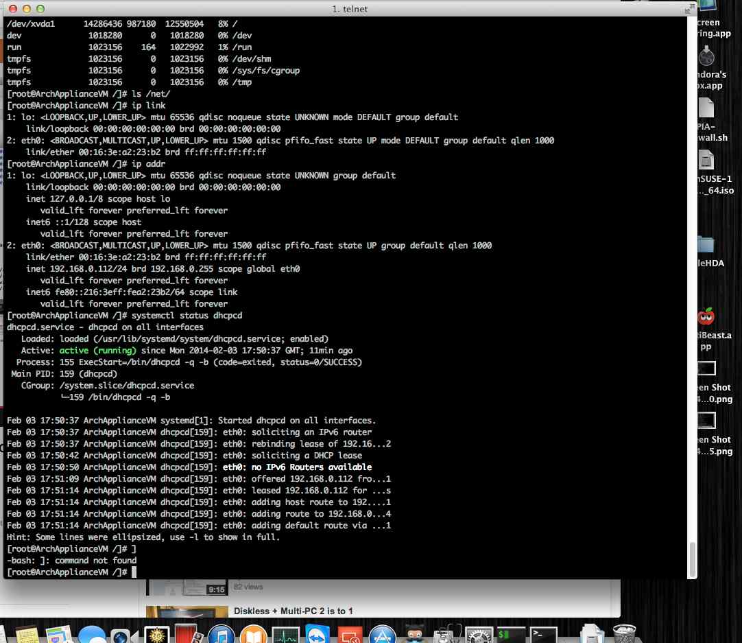

Please run ip link  and ip addr and post the output.
Also systemctl status dhcpcd please.
What's the name of your bridge? Is it xenbr0?

mount problem is still happening any ideas badger? its been booted for 4+ hours.
Do you have an ip address?
ip add
Can you ping "tower"?
ping tower
Can you ping the ip address of "tower"?
ping X.X.X.X <--- Whatever that is
If you have an IP and can ping the IP Address of "Tower"...
showmount -e <--- Whatever that is
Post back with what you find.

I just changed my unraid network.cfg and arch.cfg to  reflect "br0" instead of "xenbr0"  and rebooted the unraid machine.  (figured maybe it didnt link xenbr0...)
Same problem see below:

1. It is Ctrl + ] to escape the VM console.
2. You won't see anything under /net until you tell it where to look.
ls /net/Tower/  <--- this will show you /mnt if it worked

What am I missing? Does it not have an IP of 192.168.2.111 ? Looks like it works to me...
it does have a ip of 192.168.2.111 yes

I thought the Arch img was supposed to auto mount the shares?
I can manually mount it via
[root@ArchApplianceVM ~]# smbclient -L 192.168.2.4 -U%
params.c:OpenConfFile() - Unable to open configuration file "/etc/samba/smb.conf":
        No such file or directory
smbclient: Can't load /etc/samba/smb.conf - run testparm to debug it
Domain=[WORKGROUP] OS=[unix] Server=[samba 4.0.9]
        Sharename       Type      Comment
        BIN             Disk
        flash           Disk      Flash share
        disk1           Disk      Disk share
        disk2           Disk      Disk share
        disk3           Disk      Disk share
        cache           Disk      Disk share
        Data            Disk
        IPC$            IPC       IPC Service (Media server)
        Server               Comment
        TOWER                Media server
        Workgroup            Master
        WORKGROUP
[root@ArchApplianceVM ~]# showmount -e
Export list for ArchApplianceVM:
[root@ArchApplianceVM ~]# mkdir /mnt/tower
[root@ArchApplianceVM ~]# ls
[root@ArchApplianceVM ~]# mount -t cifs //Tower/Data/ /mnt/tower/ -o user=jsviverette,workgroup=WORKGROUP,ip=192.168.2.4
Password for jsviverette@//Tower/Data/:
[root@ArchApplianceVM ~]# cd /mnt/tower/
[root@ArchApplianceVM tower]# ls
Android  Apps  Books  Games  Misc  Movies  Music  Pictures and Home Vids  TV

It doesn't yet auto mount samba. It does automount NFS.
You could edit the VMs /etc/fstab file to make the samba stick between reboots. I installed the relevant samba utils, just didn't configure them to automount. That's why it works manually.
Tracking, how do i get it to automount NFS. I used samba as a work around because i could not get NFS to work. (which was the whole problem) Did i miss a step and noob something up?
cd /net/Tower/mnt/user/nameofshare
Update Tower to match your servers name. Also to see what shares are available run
showmount Tower -e
Example...
root@Tower:~# showmount unraid -e
Export list for unraid:
/mnt/user/Media *
thats whats not working
[root@ArchApplianceVM .custom]# showmount Tower -e
clnt_create: RPC: Unknown host
[root@ArchApplianceVM .custom]# cd /net/Tower/mnt/user/Data
-bash: cd: /net/Tower/mnt/user/Data: No such file or directory
-bash: cd: /net/Tower/: No such file or directory
tower is my server name =)
showmount Tower -e
It's in the error msg. Your server can't be called Tower, or is called something else in your router.
ok ill look into my router, for now its working with samba, thank you again!
