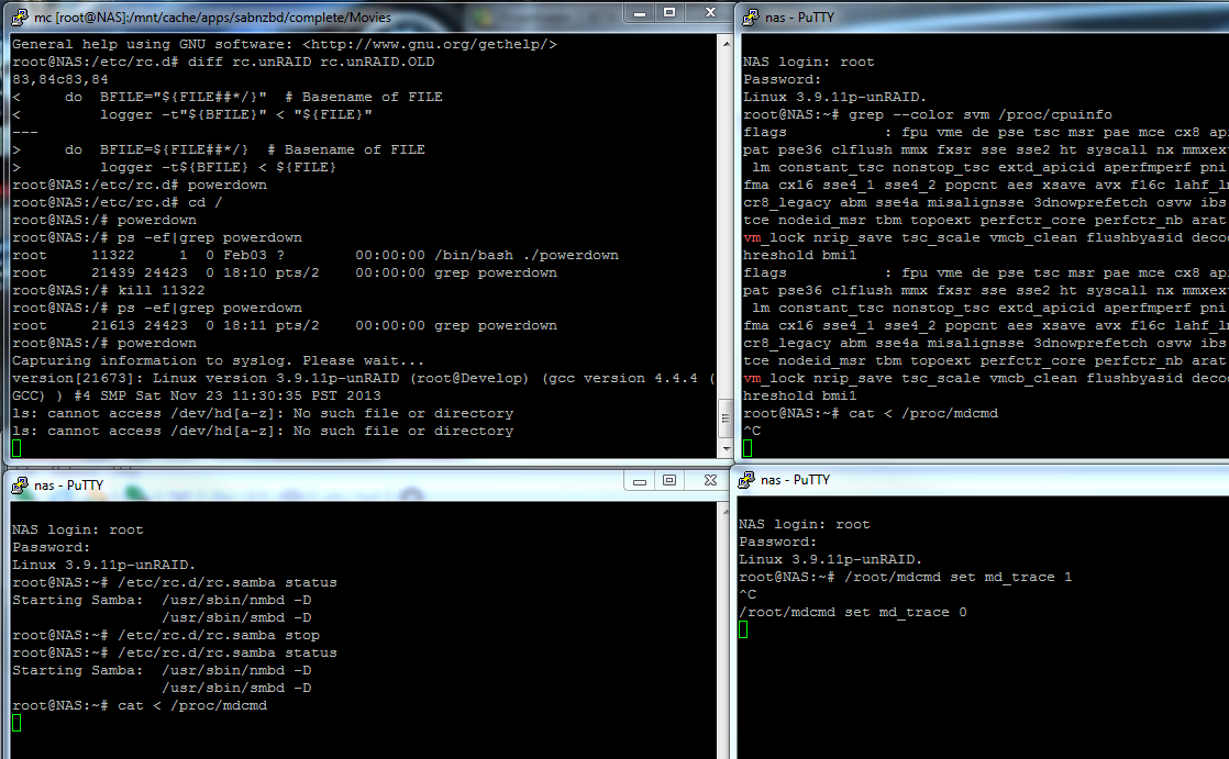

It does seem to have hung in a different place now.
root@NAS:/# powerdown
Capturing information to syslog. Please wait...
version[21673]: Linux version 3.9.11p-unRAID (root@Develop) (gcc version 4.4.4 (GCC) ) #4 SMP Sat Nov 23 11:30:35 PST 2013
ls: cannot access /dev/hd[a-z]: No such file or directory
syslog attached

I ran your first little code loop and this is what it shows me:
root@NAS:/boot# show_active.sh
nobody   12438 24236  0 17:54 ?        00:00:04 /usr/sbin/smbd -D
root     24361 24236  0 Jan29 ?        00:00:32 /usr/sbin/smbd -D
nobody   30679 24236  0 Feb03 ?        00:01:18 /usr/sbin/smbd -D
root     24222     1  2 Jan29 ?        03:21:14 /usr/local/sbin/shfs /mnt/user -
root@NAS:/boot#
but I don't know what to make of it. I've got two files downloading to the server at the moment, but I'm not too concerned if they die & I have to restart them. Otherwise, it's pretty idle.
syslog.zip

OK, I tried your suggestions, and now I can't log on to the server from a PuTTy session...  >:(  :o
In the 4 session screen shot, they are arranged in order left to right top to bottom of what I did. Now I get
NAS login: root
Password:
Login incorrect
NAS login:
when I try to log in. Yes, I've tried several times, and typed my password very slowly and carefully - I'm sure I got it right.
Also, despite my attempt to stop samba, I can still browse the server from my Win machine.
