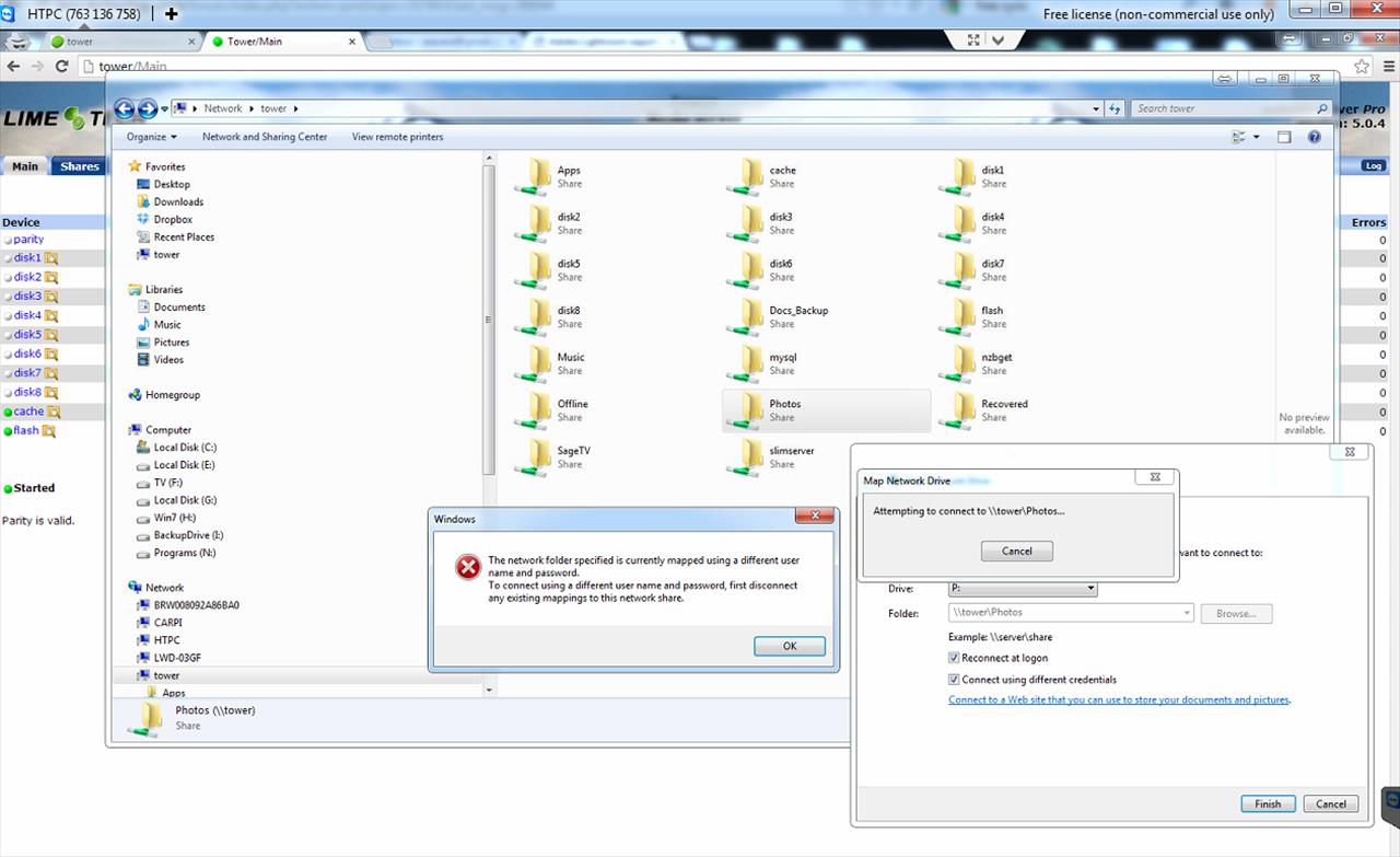

I am going to try what you have suggested.  See attached screenshot is there some other way to disconnect all mappings.  I am getting an error that says it is still connected even though in windows explorer there are no mappings showing under computer.

Not sure what to do, I have no extra mappings.  I used the net use command and none were listed.

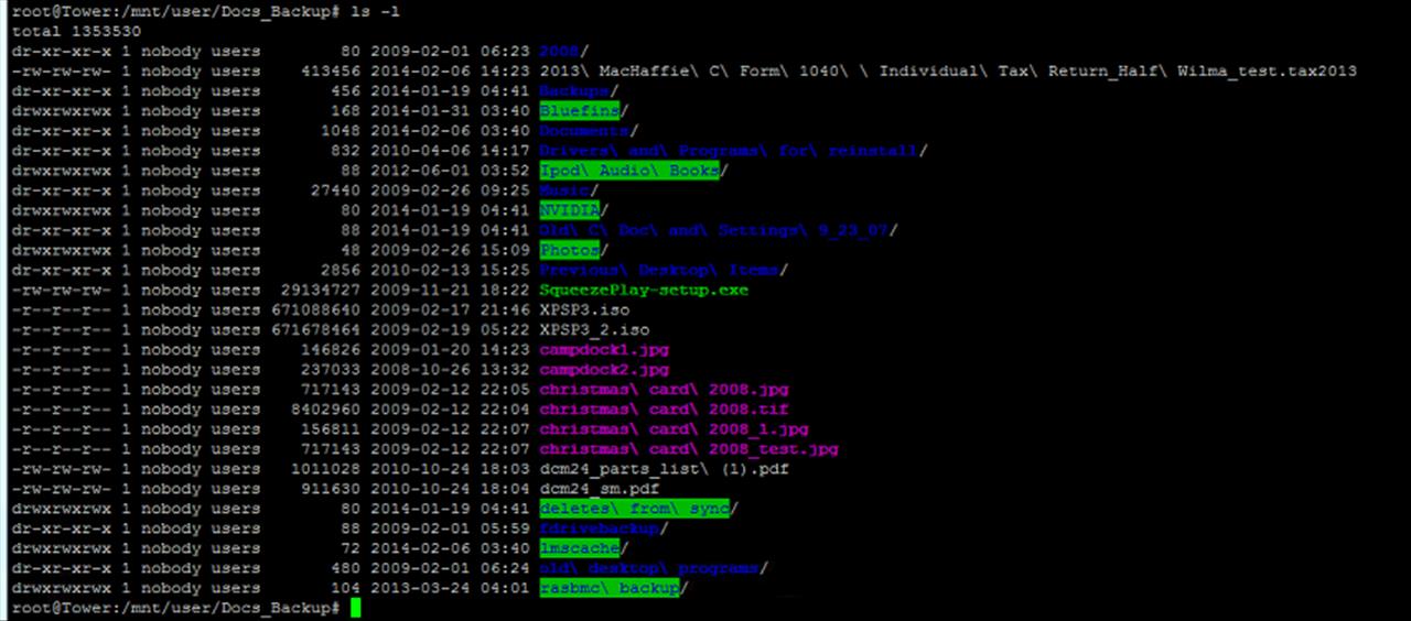

Thanks for staying with me on this issue!  We are so close.  I think I see the problem and it only occurs in one of my many user shares.  See the attached screenshot (ls -l for the one share that has the issue), look at the permissions for the folders (and a couple of the files)...the permissions aren't correct.  This explains why I was only seeing this with some programs, as the other programs are writing to other shares.  I thought the new permissions script changed these permissions along with the owner of the file.  So I assume at this point I need to CHMOD the folders and files to get the permissions correct.  Do you agree?

I did run new permissions...that is the weird part.  I made sure the window stayed open and I got the completed message at the bottom of the window.  After searching the forums telnet into the tower and ran newperms /mnt/user/Doc_Backup.  This did not change the permissions either, which is why I was thinking of chmod.

I have run the new permissions script multiple times.  I even ran the command line version for just the share that has the incorrect permissions.  See the attached screenshot....its me running the command line newperms for the share, it finishing and me doing ls -l to show the ownership and permissions.  Please note that the actual share has the correct permissions, so I can save files directly in the share (as can be seen by one of the first files in the share in the screenshot)...its the subfolders that have the incorrect permissions, as well as some files in the share.

Does "newperms /mnt/user/Doc_Backup/XPSP3.iso" change anything?
Dgaschk,
I just tried it an no...the permissions do not change...still only r permission for file group and user.
Dan
Try "chmod 777 /mnt/user/Doc_Backup/XPSP3.iso"
Dgaschk - That did change the permissions to rwx for the file group and user.
